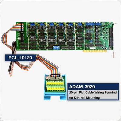

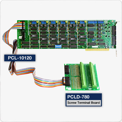

Main Features
  • 6·¶ÀÁ¢D/AÊä³ö
  • 12λ·Ö±æÂÊË«»º³åD/Aת»»Æ÷
  • ¶àÖÖµçѹ·¶Î§£º+/-10V£¬+/-5V£¬0¡ª+5V£¬0¡ª+10VºÍ4¡ª20mAµçÁ÷»·£¨»ã£©
  • 16·Êý×ÖÁ¿ÊäÈë¼°16·Êý×ÖÁ¿Êä³ö
Êý¾Ý±í(PDF) ¼¼Êõ×ÊÁÏÏÂÔØ
²úÆ·½éÉÜ
PCL-726ÊÇÒ»¿î¾ßÓÐ6·12λģÄâÁ¿Êä³öͨµÀµÄÈ«³¤¿¨.Äú¿ÉÒÔ½«Ã¿¸öͨµÀµÄÊä³ö·¶Î§ÅäÖÃΪÒÔÏÂÖµ:0µ½+5V,0µ½+10V,+/-5V,+/-10VºÍ4µ½20mAµçÁ÷»·£¨»ã£©¡£PCL-726ÊÇרÃÅΪ¹¤Òµ»·¾³Éè¼ÆµÄ£¬¶ÔÐèÒªÊä³ö¶à·ģÄâÁ¿»òµçÁ÷»·µÄÓ¦ÓÃÊÇÒ»ÏîÀíÏ룬¾­¼ÃµÄ½â¾ö·½°¸¡£³ýÁËÄ£ÄâÁ¿Êä³öÒÔÍ⣬PCL-726»¹ÌṩÁË16λÊý×ÖÁ¿Êä³öºÍ16λÊý×ÖÁ¿ÊäÈë¡£TTL¼æÈݵÄD/IºÍD/O¶Ë¿Ú¿ÉÒÔºÜÈÝÒ×µÃÓëÎÒÃÇÔÚ¹¤Òµ¿ª/¹Ø¿ØÖƼ°¼à²âÓ¦ÓÃÖÐʹÓõĶË×Ó°åÁ¬½Ó¡£

²úÆ·ÃèÊö
  PCL-726-BE
RoHS
12bit, 6ch Analog Output Card
¸½¼þ
²úÆ·ÃèÊö
  ADAM-3909-AE  DB-9 Wiring Terminal, DIN-rail Mount
  ADAM-3920-AE  20-Pin Flat Cable Terminal, DIN-rail Mount
  PCL-10120-1E  IDC-20 Flat Cable, 1m
  PCL-10120-2E  IDC-20 Flat Cable, 2m
  PCLD-780-BE  2*IDC-20 Wiring Terminal
  PCLD-782-BE  Opto-Isolated D/I Board
  PCLD-785-AE  16-ch Relay Output Terminal
  PCLD-880-AE  DB-37 Wiring Terminal
