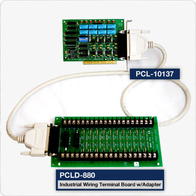

¼ÌµçÆ÷Êä³ö¼°¸ôÀëÊý×ÖÁ¿ÊäÈ뿨
Main Features
  • 8·¼ÌµçÆ÷Êä³ö8·¹â¸ôÀëÊý×ÖÁ¿ÊäÈë
  • LED¼ÌµçÆ÷״ָ̬ʾµÆ
  • ´ø¶ÔÓ¦µÄDB-37½ÓÍ·
Êý¾Ý±í(PDF) ¼¼Êõ×ÊÁÏÏÂÔØ
²úÆ·½éÉÜ
PCL-725ÊÇÒ»¿î´ø¸ôÀëµÄÊý×ÖÁ¿ÊäÈë/Êä³ö°ë³¤¿¨,¸Ã¿¨ÌṩÁË8¸ö»úµçʽSPDT¼ÌµçÆ÷Êä³öºÍ8·´ø¹âµç¸ôÀëµÄÊý×ÖÁ¿Êä³ö.¸Ã¿¨°åÔØµÄSPDT¼ÌµçÆ÷ÌØ±ðÊÊÓÃÓÚÉç±ð¿ª/¹Ø¿ØÖÆ»òµÍµçÔ´µçѹ¿ª¹Ø¹¤×÷.û¸ö¼ÌµçÆ÷¶¼´øÓÐÒ»¸öºìÉ«µÄLEDָʾµÆ,ÓÃÀ´ÏÔʾ¼ÌµçÆ÷µÄ¿ª/¹Ø×´Ì¬ÒÔ±ã¼ì²â.PCL-725µÄ8·Êý×ÖÁ¿ÊäÈëͨµÀ´øÓйâµç¸ôÀë,ÄÜÔÚÔëÉù»·¾³»òÓÐÆ¯ÒƵçѹµÄÇé¿öÏÂÕý³£¹¤×÷.Äú¿ÉÒÔͨ¹ýÌõÏßΪÿ¸öͨµÀµ¥¶ÀÉèÖÃÊäÈëͨµÀÊÇ·ñ¸ôÀë.°åÔØÒ»¸öDB-37½Ó¿Ú,ÓÃÓÚͨѶµçÀµÄÁ¬½Ó.

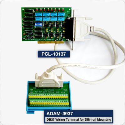

  ADAM-3937-AE  DB-37 Wiring Terminal, DIN-rail Mount
  PCL-10137-1E  DB-37 Shielded Cable, 1m
  PCL-10137-2E  DB-37 Shielded Cable, 2m
  PCL-10137-3E  DB-37 Shielded Cable, 3m
  PCLD-880-AE  DB-37 Wiring Terminal
