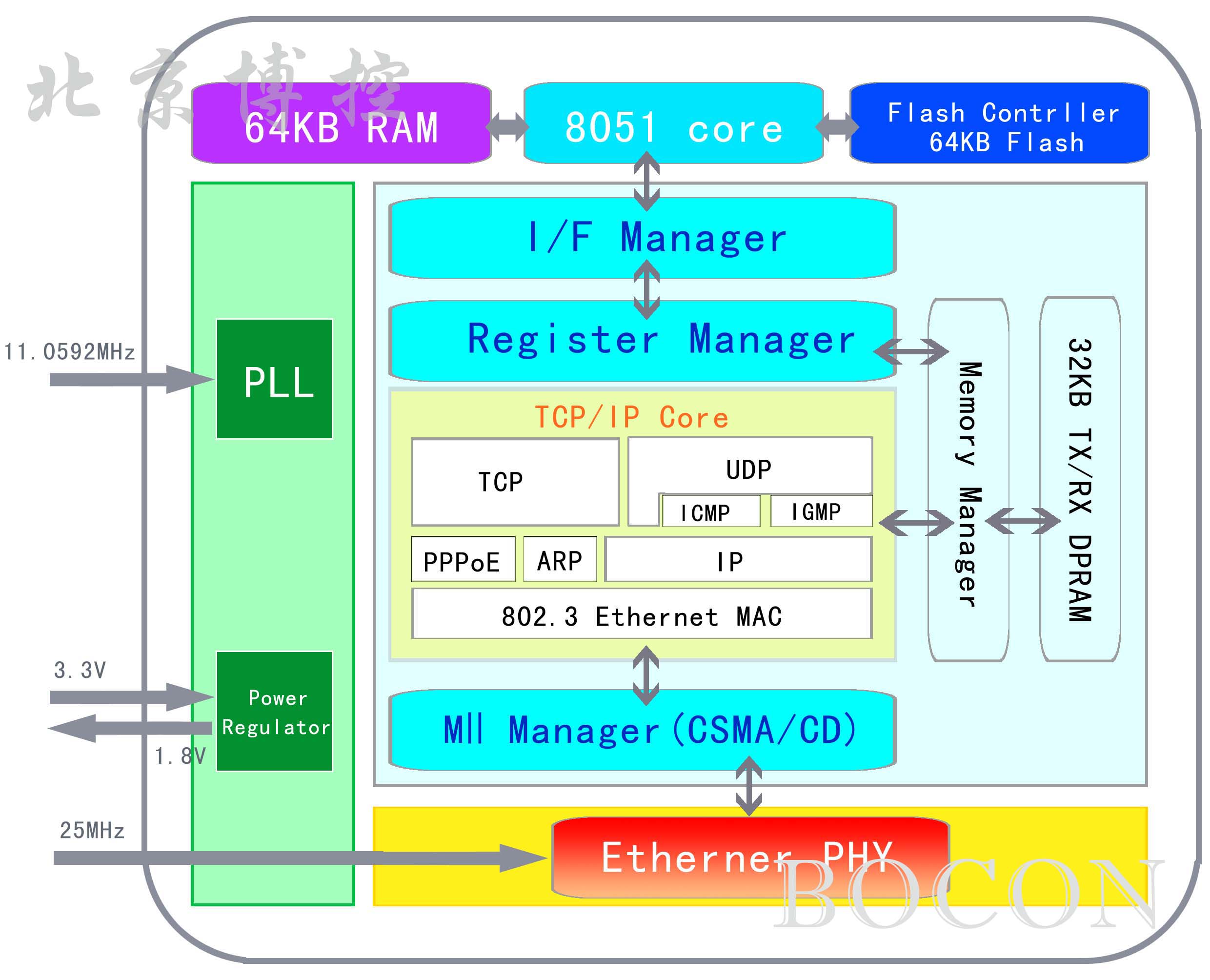

ÌØÐÔ£º
l Óë±ê×¼8051΢´¦ÀíÆ÷ÍêÈ«¼æÈÝ
l 2K×Ö½ÚÄÚ²¿Boot ROM
l 64K×Ö½ÚÄÚ²¿³ÌÐòFlash
l 128K×Ö½ÚÄÚ²¿Êý¾ÝFlash
l 64K×Ö½ÚÄÚ²¿SRAM
l ×î¸ß¿É´ï16M×Ö½ÚÍⲿ´æ´¢¿Õ¼ä
l Íⲿ11.0592MHz¾§ÕñΪÄÚ²¿PLLÂß¼­ÌṩʱÖÓÐźÅ
l Áé»îµÄÍⲿ´æ´¢½Ó¿Ú
  - Ö§³ÖÓë±ê×¼8051Ïàͬ½Ó¿Ú
  - Ö§³ÖNo-MuxAddress/Dataģʽ,¸ßËÙÍⲿ´æ´¢Æ÷Êý¾Ý´æÈ¡
l 4¸öÍⲿÖжÏ
l 4¸ö8λI/O¿Ú
l 3¸ö16λ¶¨Ê±/¼ÆÊýÆ÷
l 1¸öȫ˫¹¤UART
l ÌṩDoCDµ÷ÊÔµ¥Ôª
l Ö§³ÖÓ²¼þTCP/IPЭÒéÕ»
l Ö§³Ö8¸ö¶ÀÁ¢SOCKETͬʱͨѶ
l Ö§³ÖÈíÓ²»ìºÏTCP/IPЭÒéÕ»
l 32K×Ö½Ú¸ßËÙÄÚ²¿TCP/IPÊý¾Ý´¦Àí»º´æ
l ÄÚǶ10/100MbpsÒÔÌ«ÍøÎïÀí²ã
l 3.3V¹¤×÷µçѹ£¬I/O¿Ú5VÄÍѹ
l 100½ÅLQFPÎÞǦ·â×°
