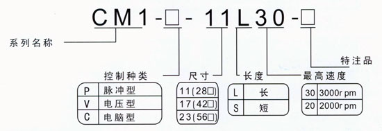

CM1-□-
11L30
CM1-□-
11L30
CM1-□-
17L30
CM1-□-
17L30
CM1-□-
23L20
CM1-□-
23L20
