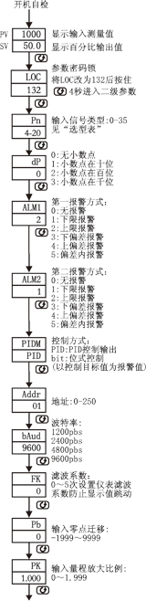

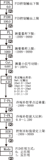

²ÎÊý¹¦ÄÜ
    ×¢£ºÒÔÉϲÎÊýΪÒDZíÈ«²¿²ÎÊý£¬Èç¹û²»ÊÇÈ«¹¦ÄÜÒÇ±í£¬Ôòδѡ¹¦ÄÜËù¶ÔÓ¦µÄ²ÎÊý½«²»ÓèÏÔʾ¡£

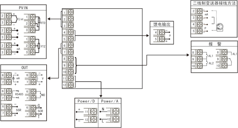

ÒDZí½ÓÏßͼ
ͼһ

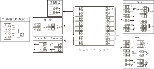

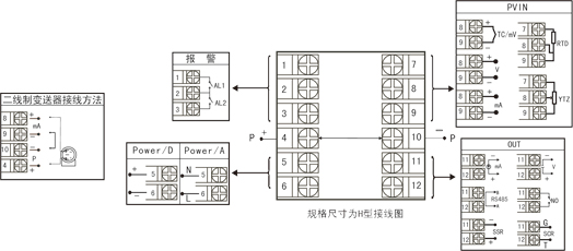

    ¹æ¸ñ³ß´çΪA¡¢B¡¢C¡¢D¡¢EÐͽÓÏßͼ
    ×¢£ººáÊúʽÒDZíºó¸Ç½ÓÏß¶Ë×Ó·½Ïò²»Ò»Ñù£¬¼ûʾÒâͼ1¡£
    ×¢£ºÉÏÊö½ÓÏßͼÖÐÔÚͬһ×é¶Ë×Ó±êÓв»Í¬¹¦ÄܵÄ,Ö»ÄÜÑ¡ÔñÆäÖÐÒ»ÖÖ¹¦ÄÜ¡£ÈçRS485ͨѶ¹¦ÄܺͿØÖÆÊä³ö¹¦ÄÜÔÚͬһ×éOUT½ÓÏß¶Ë×ÓÉÏ£¬Ö»ÄÜÑ¡ÔñÒ»ÖÖ¡£ÈôÁ½ÕßÐèͬʱ´æÔÚʱ,¿ØÖÆÊä³öÖ»ÄÜÑ¡Ôñ¿ª¹ØÁ¿Êä³öÇÒ½ÓÏß¶Ë×ÓÔÚAL2ÉÏ¡£
