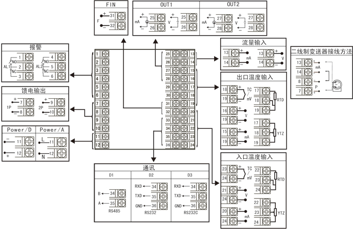

ÒDZí½ÓÏßͼ
    ¹æ¸ñ³ß´çΪA¡¢B¡¢CÐͽÓÏßͼ
    ×¢£ººáÊúʽÒDZíºó¸Ç½ÓÏß¶Ë×Ó·½Ïò²»Ò»Ñù£¬¼ûʾÒâͼ1¡£
ͼһ
