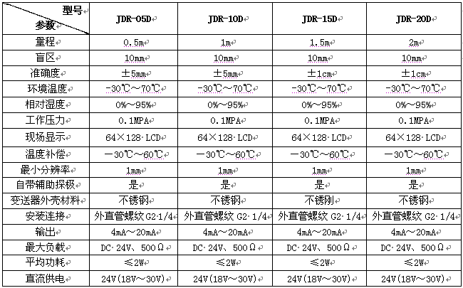

¼¼Êõ²ÎÊý
¹æ¸ñÑ¡ÐÍ
˵Ã÷£º JDR-05D Îª0.5Ã×Á¿³ÌµÄµ¥½çÃæÓÍ¡¢Ë®ÒºÎ»±äËÍÆ÷¡£
       JDR-10D Îª1.0Ã×Á¿³ÌµÄµ¥½çÃæÓÍ¡¢Ë®ÒºÎ»±äËÍÆ÷¡£
       JDR-15D Îª1.5Ã×Á¿³ÌµÄµ¥½çÃæÓÍ¡¢Ë®ÒºÎ»±äËÍÆ÷¡£
       JDR-20D Îª2.0Ã×Á¿³ÌµÄµ¥½çÃæÓÍ¡¢Ë®ÒºÎ»±äËÍÆ÷¡£
       0.5-2.0ÃׯäËüÁ¿³Ì¿É¶¨ÖÆ
