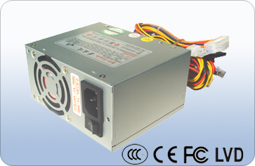

²úÆ·Ãû³Æ£º ÊÓÆµ¼à¿ØÖ÷»úµçÔ´ DVRרÓõçÔ´
ÐÍ ºÅ£º P4-335U
Æ· ÅÆ£º 4720
ËùÊôÀà±ð £º SFX µçÔ´
²úÆ·Ãû³Æ £º ¸ß¶ËСµçÔ´ 230W
function goToFavorite() { var time = new Date(); window.location = "Favorite.html?Favorite_ProductID=c373e91eed3071068f6ec6fd13050d91&Favorite_action=add&time=" + time.getTime(); }
¶î¶¨¹¦ÂÊ £º 230W
×î´ó¹¦ÂÊ £º 335W
²úÆ·ÐͺŠ£º P4-335TB/TU
³¤*¿í*¸ß £º 100*125*63.5mm
¸ß¶ËСµçÔ´ 230W
²úƷ˵Ã÷£º
P4-335TB/TU
²úƷͼƬ
³ß´ç£º 100*125*63.5mm
Ó¦ÓÃϵͳ£º for PC
ÍßÌØÊý£º230W
¹¦ÂÊÒòËØ£ºPassive(Optional)
ÌØµã :
  • ·ûºÏSFX12V 3.2°æ±¾,¶î¶¨230W(×î´ó335W)
• Ö§³ÖDual Core CPU¼¼Êõ
• ¸ßЧÂÊ
• µÍÁ°²¨ÔÓѶÊä³ö
• ¸÷×éÊä³ö¾ß±¸¹ýµçѹ±£»¤
• ¸÷×éÊä³öµçѹ¾ß±¸¶Ì·µçÁ÷±£»¤
• ÄÚÖÃ6CMÉ¢ÈÈ·çÉÈ
• 100%¸ßÎÂÀÏ»¯²âÊÔ(50¡æ)
• ÊÙÃüÖÜÆÚ:¡Ý80KHСʱÒÔÉÏ
ÏßÀÂÓ¦Óà :
20+4P Ö÷½ÓÍ·
4Pin ½ÓÍ·
4Pin ÍâÉèÉ豸½ÓÍ·
4Pin ÈíÇýÉ豸½ÓÍ·
SATA ½ÓÍ·
ÊäÈë¹æ¸ñ :
  • ÊäÈëµçѹ£º¡¡115/220-230V
• ƵÂÊ£º¡¡¡¡¡¡47-63Hz
• ÊäÈëµçÁ÷£º¡¡5A @115Vac 60Hz,;3A @220-230Vac 50Hz
Êä³ö¹æ¸ñ :
  • ×î´ó¹¦ÂÊ:¡¡¡¡¡¡335W
• ÑÕÉ«:¡¡¡¡¡¡¡¡¡¡Silver
• É¢ÈÈϵͳ:¡¡¡¡¡¡SPEED: 3500RMP(+/-10%)
¡¡¡¡¡¡¡¡¡¡¡¡¡¡¡¡DIMENSION:100*125*63.5mm
¡¡¡¡¡¡¡¡¡¡¡¡¡¡¡¡TEMP.AUTO ONTROL:
¡¡¡¡¡¡¡¡¡¡¡¡¡¡¡¡1800rpm at 41.7¡æ~3500rpm at 60.5¡æ
¡¡¡¡¡¡¡¡¡¡¡¡¡¡¡¡6CM Fan
. ÔëÒô:¡¡¡¡¡¡¡¡¡¡22dB at 3200rpm
. P.GÐźÅ:¡¡¡¡¡¡100-500ms
. ±£³Öʱ¼ä:¡¡¡¡¡¡17ms(min)
. ЧÂÊ:¡¡¡¡¡¡¡¡¡¡75%
Êä³ö :
Output Voltage
Min. load
Max. load
Load Reg.
Ripple & Noise
-12V
0.0A
0.5A
¡À10%
120mV P-P
+3.3V
0.1A
14.0A
¡À5%
50mV P-P
+5V
0.2A
23.0A
¡À5%
50mV P-P
+5Vsb
0.0A
2.0A
¡À5%
50mV P-P
+12V
0.6A
14.0A
¡À5%
120mV P-P
£®+3.3V & +5V total output shall not exceed 80W.
£®+3.3V & +5V & +12V1 total output shall not exceed 185W
£®TB for no Passive;TU for Passive
£®Detailed specifications and drawings provided upon request.
