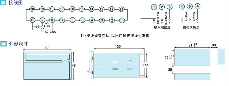

²úÆ·Ãû³Æ£º DP3-SVA1B´«¸ÐÆ÷רÓÃÊýÏÔ±í À­ËÙ±í
ÐÍ ºÅ£º DP3-SVA1B
Æ· ÅÆ£º 798
ÌØµã£º
  • ±¾²úÆ·ÊÊÓÃÓÚ¸÷ÖÖ¾ßÓÐÏßÐÔÊä³öÌØÐԵĴ«¸ÐÆ÷»òÆäËû²âÁ¿É豸£¬ÈçѹÁ¦¡¢ÖØÁ¿¡¢Î¶ȡ¢Êª¶ÈµÈµÄ²âÁ¿¡£
  • ¾ßÓÐСÊýµãÉ趨¡¢±ÈÂÊ¡¢Á¿³Ì¼°Áãµãµ÷Õû¹¦ÄÜ¡£
  • ¾ßÓÐÄ£Äâ±äËÍÊä³ö¹¦ÄÜ(4¡«20mA)
  • ´ø¸¨ÖúµçÔ´Êä³ö+12V¡¢+24V ¡£
  • Ò»¡¢²úÆ·ÐͺŹæ¸ñ:
    ÐͺŹæ¸ñ ±äË͹¦ÄÜ ¸¨ÖúµçÔ´ ¾«¶È ²ÉÑùËÙ¶È ÍâÐγߴç
    DP3-SVA1A  ÎÞ  DC 12V  ¡À0.5%FS¡À2Digit £¨23¡æ¡À5¡æ£©  Ô¼2.5´Î/Ãë  48mm(H)¡Á96mm(W)¡Á100mm(D£©DIN
    DP3-SVA2A  ÓÐ  DC 12V  ¡À0.5%FS¡À2Digit £¨23¡æ¡À5¡æ£©  Ô¼2.5´Î/Ãë  48mm(H)¡Á96mm(W)¡Á100mm(D£©DIN
    DP3-SVA1B  ÎÞ  DC 24V  ¡À0.5%FS¡À2Digit £¨23¡æ¡À5¡æ£©  Ô¼2.5´Î/Ãë  48mm(H)¡Á96mm(W)¡Á100mm(D£©DIN
    DP3-SVA2B  ÓÐ  DC 24V  ¡À0.5%FS¡À2Digit £¨23¡æ¡À5¡æ£©  Ô¼2.5´Î/Ãë  48mm(H)¡Á96mm(W)¡Á100mm(D£©DIN
    ¶þ¡¢ÌØÊâ¶©»õÒªÇó:
    ×𾴵Ŀͻ§£¬µ±ÎÒÃÇÒÔÉÏËùÌṩµÄÐͺż°¹æ¸ñ²»ÄÜÂú×ãÄúµÄÐèÇóʱ£¬ÇëÓë±¾¹«Ë¾ÁªÏµ¡£
    Èý¡¢²úÆ·ÆäËüÌØÐÔ²ÎÊý:
    ÌØÐÔÏîÄ¿ ¾ßÌå²ÎÊý
    ²âÁ¿¹¦ÄÜ  Óë¸÷ÖÖ´«¸ÐÆ÷ÅäÌײâÁ¿
    ÊäÈ뷽ʽ  µçÁ÷£º4¡«20mA(0¡«20mA)  µçѹ£º  0¡«10V  (0¡«1V,  1¡«5V,  0¡«5V,  0¡«200mV)
    A/Dת»»  ¶þÖØ»ý·Ö
    ÏìÓ¦ËÙ¶È  Ô¼4.5Ãë
    ×î´óÏÔʾ  1999  ×ÔÓÉÉ趨СÊýµã
    ÏÔ    ʾ  ºìÉ«ÊýÂë¹Ü¸ß14.2mm
    ÏûºÄ¹¦ÂÊ  ¡Ý3.5VA
    ʹÓÃζȠ 0¡æ¡«50¡æ
    µç    Ô´  AC    110V/220V      50/60Hz
    ±äËÍÊä³ö¸ºÔØ  ¡Ü600¦¸
    ÖØ    Á¿  350g
    Ä͵çѹ  AC  1500V    1min
    ¾øÔµ×迹  DC  500V  ¡Ý100M¦¸

    1¡¢ÊÊÒËʹÓû·¾³Î¶È0¡æ¡«50¡æ£¬Ïà¶Ôʪ¶È85%ÒÔÏ¡£
    2¡¢ÊäÈëµ¼Ïß²»Ò˹ý³¤£¬Ê¹ÓÃÆÁ±ÎÏ߽Ϻá£
    3¡¢Ê¹ÓÃʱӦԶÀë¸ÉÈÅÔ´¡£
    4¡¢·ÀֹǿÁÒÕ𶯺ͳå»÷¡£
    5¡¢·ÀÖ¹´óÁ¿»Ò³¾ÒÔ¼°Óꦻ¯Ñ§Ò©Æ·ÇÖÈë¡£
    6¡¢±£´æÔÚÎÞÖ±Éä¹âÏߣ¬-10¡æ¡«+70¡æÎ¶ȣ¬60%ÒÔÏÂʪ¶ÈµÄµØ·½¡£ÇÐÎðºÍÓлúÈܼÁ»òÓÍÎï½Ó´¥¡£
