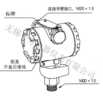

²úÆ·Ãû³Æ£º ÎÞÎýѹÁ¦ËͱäÆ÷
ÐÍ ºÅ£º DPSY-A
Ò»¡¢¸ÅÊö£º
DPSY-AÀ©É¢¹èѹÁ¦±äËÍÆ÷ÊÇÎÒ¹«Ë¾×îпª·¢ÑÐÖÆµÄÒ»ÖÖÐÂÐ͹¤ÒµÑ¹Á¦±äËÍÆ÷¡£²ÉÓò»Ðâ¸Ö·À¸¯Ê´½á¹¹Ì壬ÊÊÓÃÓÚÒ»°ãÐÔÒºÌåºÍÆøÌåµÄѹÁ¦²âÁ¿¡£¿ÉÓÃÓÚ×ÔÀ´Ë®¡¢Ê¯ÓÍ´«Êä¡¢»¯¹¤¹ý³Ì£¬ÒÔ¼°¸÷ÖÖϵͳѹÁ¦²âÁ¿£¬ÒÔ´ïµ½¼ÆÁ¿¡¢¿ØÖÆ¡¢±¨¾¯¡¢µ÷¶È¡¢½ÚÄܵÈÄ¿µÄ¡£
¶þ¡¢Ö÷ÒªÌØµã£º
1¡¢½á¹¹Ð¡ÇÉ¡¢°²×°·½±ã£¬¿ÉÖ±½Ó°²×°£¬Ò²¿É²ÉÓÃÖ§¼Ü°²×°¡£
2¡¢ÏȽøµÄĤƬ/³äÓ͸ôÀë¼¼Êõ¡£
3¡¢¸ßÎȶ¨ÐÔ¡¢¸ß¿É¿¿ÐÔ¡£
4¡¢ÄÍÕ𣬿¹É䯵¸ÉÈÅ¡£
5¡¢ÆäÖй¤ÒµÐÍΪһÌ廯½ÓÏߺУºËùÓÐµçÆø½ÓÏß¶¼Ö±½ÓÓë±äËÍÆ÷Íâ¿ÇµÄÏÖ³¡¶Ë×ÓÇ»ÊÒÏàÁ¬¡£´Ó¶øÏû³ýÁ˰²×°Öмä½ÓÏߺÐËù´øÀ´µÄ·ÑÓúÍÂé·³¡£
Èý¡¢Ö÷Òª¼¼Êõ²ÎÊý£º
1¡¢Á¿³Ì£º0-200PaÖÁ0-100MPa£»-0.1MPa--+0.1MPa
2¡¢¾«¶È£º¡À0.25%F.S;¡À0.5%F.S£¨Ò»°ãΪ0.5%F.S£©£»
3¡¢ÎÂÇø£º0-60¡æ
4¡¢µçÔ´£º24DCV(9¡«36DCV) ;
5¡¢Êä³ö£º4¡«20mA(¶þÏßÖÆ)¡¢0¡«5V¡¢1¡«5V¡¢0¡«10V(ÈýÏßÖÆ) ;
6¡¢¹ýÔØ£ºÁ¿³Ì¡Á1.5±¶£»
7¡¢·À±¬¼¶±ð£ºEXia¢òCT5£»
8¡¢·À³¾·À³±£ºÈ«Ììºò£»
9¡¢Ö¸Ê¾±íÍ·£º3 1/2λҺ¾§ÏÔʾ£¨Óû§¶©»õʱÐëÁíÖ¸Ã÷£©¡£
