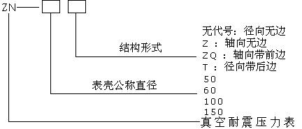

ÐͺÅÃüÃû£º

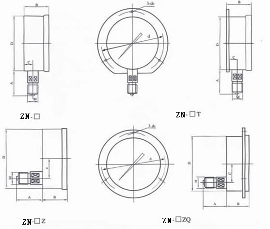

ÍâÐγߴç
ÐͺÅ
ÍâÐγߴç mm
A
B
C
D
d
d0
M
ZN-50Z
29
24
0
14X1.5
ZN-60
31
32
14
60
ZN-60T
31
32
15
75
3.4
ZN-60Z
30
32
0
ZN-60ZQ
30
32
0
75
3.4
ZN-75
24
30
12
75
ZN-75T
24
30
12
90
5.5
ZN-75Z
24
30
0
ZN-75ZQ
24
30
0
90
5.5
ZN-100
44
45
18
100
20X1.5
ZN-100T
44
46
19
118
5.5
ZN-100Z
43
45
34
ZN-100ZQ
43
45
44
118
5.5
ZN-150
47
19
149
20X1.5
ZN-150T
48
20
165
5.5
ZN-150Z
51
47
55
ZN-150ZQ
51
47
55
165
5.5
