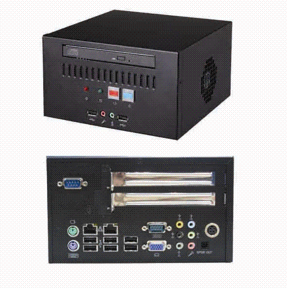

Form Factor  Mini-ITX bare-bone system
Construction  Heavy-Duty steel
Mini-ITX Board / CPU
 Inside Motherboard : LV-67F series
 Support CPU : Intel® Core™  i7/i5/i3 mobile with integrated graphic
Drive Bay  External : 1 x Slim CD-ROM Space
 Internal  : 1 x 2.5" HDD Space
Extensive slot
 1 x PCIE x16 slot
 ( Re-check the power consumption & physical issue before purchase )
 1 x slot room for Mini-PCI or Mini-PCIe daughter board
Thermal Control  One 6 cm system cooling Fan
Front Panel
 Power on switch
 System Reset switch
 LED forPower On/Off and HDD activity
 2 x USB ports
 Mic-in / Ear phone

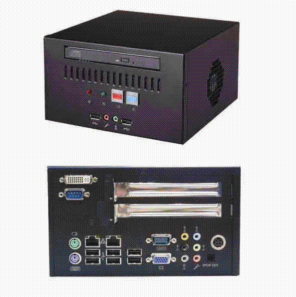

Rear Side I/O
 CMB-67FX
 CMB-67FXD
 CMB-67FXT
Environment  Operating Temperature: 0 ~ 50ºC
Power supply  12V/ 80W adapter with 4-pin Mini DIMM
Dimension  199 x 189 x 110 mm
Weight  1.31 kgw , (Without HDD, CPU cooler )
