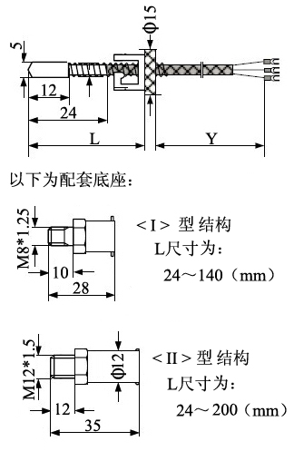

WZP-SϵÁжËÃæpt100ζȴ«¸ÐÆ÷²ÉÓýèÖúµ¯»Éµ¯Á¦, ʹ²âζ˺ͱ»²âÎïÌå½ôÃܽӴ¥£¬ÕâÖÖ²âÁ¿·½Ê½¾ßÓвâÎÂËٶȿ죬²âÁ¿×¼È·¶È¸ßµÈÌØµã£¬ÊÊÓÚ²âÁ¿µç»úÖáÍß¡¢ËÜÁÏ»úе¡¢µç³§ÆûÂÖ»ú¡¢Ä£¾ß»òÆäËüÎïÌå±íÃæÎ¶ȡ£

          Àà  ÐÍ
Íâ ÐΠʾ Òâ ͼ
½á ¹¹ ʾ Òâ ͼ
             A
   ³£Óùæ¸ñ:
             ¢ñ£º D=6      M=M8*0.75
             ¢ò£º D=8      M=M10*1
             B
             C
                                                                                         Ñ¡    ÐÍ    ±í
WZP- S
²¬Èȵç×èÐͺÅ
¡õ
1=ÀàÐÍA
        IÐÍ      ( D=6   M=M8*0.75)
       IIÐÍ      ( D=8   M=M10*1)
2=ÀàÐÍB
3=ÀàÐÍC
       IÐÍ        (LΪ24¡«140 mm)
       IIÐÍ       (LΪ24¡«200 mm)
Ö¸¶¨
¶ËÃæÈȵç×èÀàÐÍ
B¡õ
1=Pt100    5=Pt500    10=Pt1000
´«¸ÐÆ÷ÀàÐÍ
T¡õ
1=0¡«80    2=-50¡«100    3=-50¡«150    4=-50¡«200   Ö¸¶¨
ζȷ¶Î§(¡æ)
P¡õ
B=B¼¶          A=A¼¶         Ö¸¶¨
´«¸ÐÆ÷¾«¶È
Y¡õ
1=1000   2=2000   Ö¸¶¨
ÒýÏß³¤¶È(mm)
E¡õ
2=Á½Ïß     3=ÈýÏß     4=ËÄÏß
ÒýÏßÏßÖÆ
F¡õ
1=¾ÛÂÈÒÒÏ©PVC£¨-20¡«80¡æ£©
2=¾Û°±õ¥TPU £¨-50¡«100¡æ£©
3=ÌØ·úÁú (-50¡«250¡æ£©
Ö¸¶¨
ÒýÏß²ÄÖÊ
À¨ºÅÄÚΪÒýÏß³£ÓÃζȷ¶Î§
H¡õ
0=¾ùÎÞ,¿É²»Ìî
1=¾ùÓÐ
µ¼Ï߯Á±Î²ã /
ÏßÀ»¤Ì×
Z¡õ
0=ÎÞ,¿É²»Ìî
1=»¤Ïßµ¯»É
Ö¸¶¨
ÌØÊâÒªÇó
±¸×¢£º¶ÔÓÚÓû§Ö¸¶¨µÄ²ÎÊýÒªÇó£¬Ö±½ÓÒÔÊý×Ö»òÎÄ×Ö±ê×¢³öÀ´¼´¿É
Ñ¡Ð;ÙÀý£ºWZP-S1II/B1-¡¡T2-¡¡PA-  Y1-¡¡E3/F3/H1
˵Ã÷: PT100,²âη¶Î§-50¡«100¡æ£¬¾«¶ÈA¼¶£¬ÒýÏß³¤1£í£¬ÈýÏßÖÆ,½á¹¹ÎªAÀàÐÍÖÐIIÐÍ£¬D=8, M=M10*1
