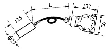

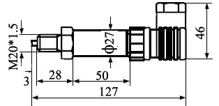

ʵ Îï ͼ
½á ¹¹ ʾ Òâ ͼ
A1
ÂÝÎÆÁ¬½Ó

B
Ò»ÌåͶÈëʽ
C
·ÖÌåͶÈëʽ

I=A1,  ¢ò=A2 (ÂÝÎÆ°²×°,M20¡Á1.5,ÂÝÎÆÒ²¿ÉÖ¸¶¨)
