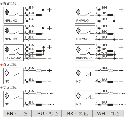

Ö±Á÷3Ïß/DC 3-Wire
ÐͺÅ/type
NPN.NO
FN5-M18G12-NOD1
MN8-M18G12-NOD1
NPN.NC
FN5-M18G12-NCD1
MN8-M18G12-NCD1
NPN.NO+NC
FN5-M18G12-NHD1
MN8-M18G12-NHD1
PNP.NO
FN5-M18G12-POD1
MN8-M18G12-POD1
PNP.NC
FN5-M18G12-PCD1
MN8-M18G12-PCD1
PNP.NO+NC
FN5-M18G12-PHD1
MN8-M18G12-PHD1

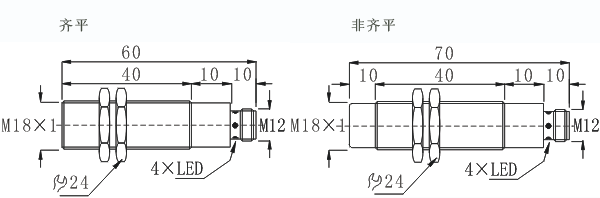

ÍâÐιæ¸ñ/Form Factor
M18*50
M18*60
°²×°·½Ê½/Installation
Æëƽ/shielded
·ÇÆëƽ/unshielded

Ö±Á÷2Ïß/DC 2-Wire
ÐͺÅ/type
NO
FN5-M18G12-DOD1
MN8-M18G12-DOD1
NC
FN5-M18G12-DCD1
MN8-M18G12-DCD1
ÍâÐιæ¸ñ/Form Factor
M18*50
M18*60
Æëƽ/shielded
·ÇÆëƽ/unshielded

½»Á÷2Ïß/AC 2-Wire
ÐͺÅ/type
SCR.NO
FN5-M18G12-AOA1
MN8-M18G12-AOA1
SCR.NC
FN5-M18G12-ACA1
MN8-M18G12-ACA1
ÍâÐιæ¸ñ/Form Factor
M18*60
M18*60
Æëƽ/shielded
·ÇÆëƽ/unshielded

ÍâÐÎ³ß´ç £¨µ¥Î»mm£©             £¨ÍâÐγߴç¿É¸ù¾Ý¿Í»§ÒªÇó¶¨ÖÆ£©
µçÆø½ÓÏßͼ
