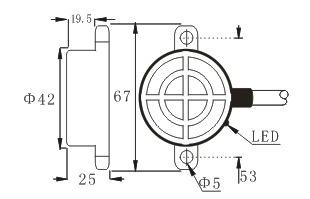

ÍâÐÎ³ß´ç £¨µ¥Î»mm£©             £¨ÍâÐγߴç¿É¸ù¾Ý¿Í»§ÒªÇó¶¨ÖÆ£©
