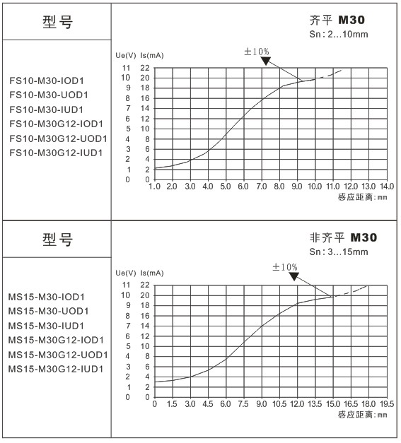

¡ï ¿ÉʵÏÖ½ðÊôÖ®¼äÎ»ÒÆ³É±ÈÀýµÄµçÁ÷»òµçѹÐźţ¬´ËÐźųÊÏßÐÔ¹ØÏµ

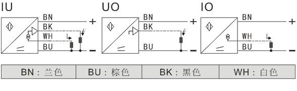

DC3/4Ïß µç¸ÐʽģÄâÁ¿Êä³ö
ÐͺÅ/type
µçÁ÷0-20mA
FS10-M30G12-IOD1
MS15-M30G12-IOD1
µçѹ0-10V
FS10-M30G12-UOD1
MS15-M30G12-UOD1
µçÁ÷+µçѹ0-20mA+0-10V
FS10-M30G12-IUD1
MS15-M30G12-IUD1

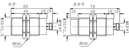

ÍâÐιæ¸ñ/Form Factor
M30*60
M30*70
°²×°·½Ê½/Installation
Æëƽ/shielded
·ÇÆëƽ/unshielded
¼ì²â¾àÀë/Sensing distance
2¡­10mm
4¡­10mm
¿ª¹ØÆµÂÊ/switching frequency
150Hz
100Hz
µçÔ´µçѹ/Supply voltage
15-30V DC
ÖØ¸´¾«¶È/Repeatability
¡Ü5%¡ÀSr
ÏßÐÔÎó²î/ Linearity Error
¡Ü3%¡ÀSr
¸ÐÓ¦¾àÀëÎó²î/ Sensing distance error
¡Ü10%
µçѹ½µ/Voltage drop
±£»¤µç·/Protection circuit
¶Ì·¡¢¼«ÐÔ·´½Ó±£»¤
¸ºÔصç×è/ Load Resistance
(µçѹ¡Ý4.7K),(µçÁ÷¡Ü500¦¸)
¿ÕÔØµçÁ÷/No-load supply current
¡Ü10mA
Êä³öÏÔʾ/Output Display
ÂÌÉ«µçѹָʾµÆ/Green LED
¹¤×÷ζȷ¶Î§/Operating temperature
-25¡­70¡æ
»·¾³Êª¶È/Humidity
35-95%RH
Íâ¿Ç²ÄÁÏ/Housing material
¶ÆÄø»ÆÍ­/nickel plated brass
Á¬½Ó·½Ê½/Connection
M12Á¬½ÓÆ÷/ M12 connector
ÍâÐÎ³ß´ç £¨µ¥Î»mm£©             £¨ÍâÐγߴç¿É¸ù¾Ý¿Í»§ÒªÇó¶¨ÖÆ£©
µçÆø½ÓÏßͼ
