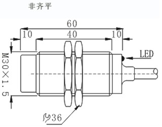

ÍâÐιæ¸ñ/Form Factor
M30*50
M30*60
°²×°·½Ê½/Installation
Æëƽ/shielded
·ÇÆëƽ/unshielded

ÍâÐÎ³ß´ç £¨µ¥Î»mm£©                  ÍâÐγߴç¿ÉÒÔ¸ù¾Ý¿Í»§ÒªÇó¶¨ÖÆ
