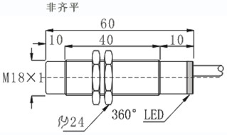

ÍâÐÎ³ß´ç £¨µ¥Î»mm£©                  ÍâÐγߴç¿ÉÒÔ¸ù¾Ý¿Í»§ÒªÇó¶¨ÖÆ
