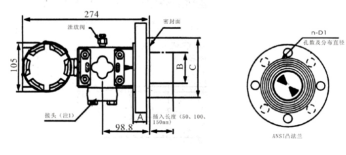

²úÆ·Ãû³Æ£º MDM4951LTÐÍ ÒºÎ»±äËÍÆ÷
ÐÍ ºÅ£º MDM4951LT

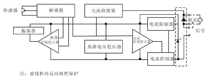

£®±¾¹«Ë¾Éú²úµÄͨÓÃÐÍMDM4951ϵÁеçÈÝʽѹÁ¦¡¢²îѹ±äËÍÆ÷ÓÐÏÂÁÐÌØµã£º
£®Æ·ÖÖÆëÈ«¡¢¾«¶È¸ß¡¢Îȶ¨ÐԺ㬼۸ñ±ÈͬÀà½ø¿ÚÒDZí±ãÒË£»

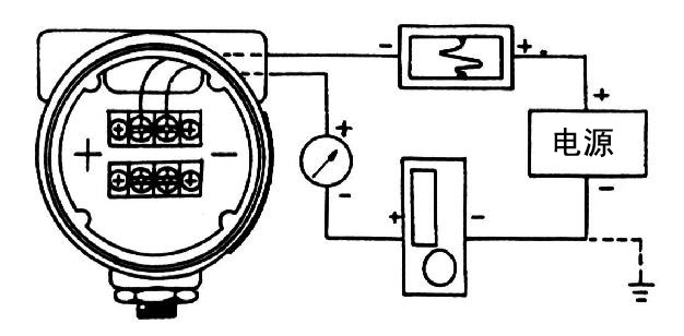

£®²ÉÓöþÏßÖÆµÄ¹¤×÷·½Ê½£»
£®Ãô¸ÐÔª¼þ²ÉÓùÌÌ廯½á¹¹£¬Ð¡Ðͼá¹Ì£¬ ¿¹ÕñÄÜÁ¦Ç¿£»
£®Á¿³ÌºÍÁãλ¿ÉÔÚÍⲿÁ¬Ðøµ÷½Ú£»
£®Ö÷Òª²¿¼þ¿ÉÓë1151ͬÀà²úÆ·½øÐл¥»»£»
£®¹Ø¼üÁ㲿¼þ¡¢µç×ÓÔª¼þ¼°½Ó²å¼þ¾ù²ÉÓùú¼Ê¸ßÖÊÁ¿²úÆ·¡£Òò´Ë¿É¿¿ÐԺ㬠ÖÊÁ¿Îȶ¨£¬ ¹ÊÕÏÂÊ
  µÍ£»
£®ÕýÇ¨ÒÆ¿É´ï500£¥£¬¸ºÇ¨Òƿɴï600£¥ (×îСÁ¿³Ìʱ)£»
£®×èÄá¿Éµ÷£»
£®LCD 3 1/2 λҺ¾§ÏÔʾָʾÆ÷ºÍÖ¸Õëָʾ±í¡£
