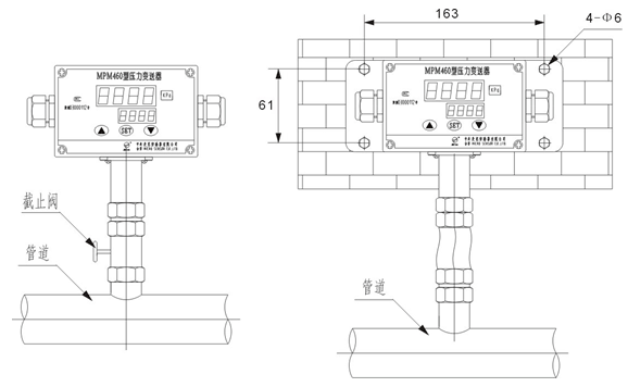

Ó¦ÓÃʾÀý

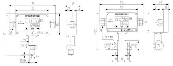

(µ¥Î»£ºmm)
MPM460
ÐͶ๦ÄÜÖÇÄÜѹÁ¦±äËÍ¿ØÖÆÆ÷

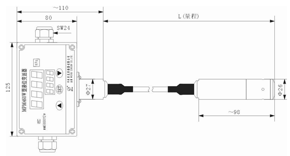

MPM460W
ÐͶ๦ÄÜÖÇÄÜҺλ±äËÍ¿ØÖÆÆ÷
MDM460
ÐͶ๦ÄÜÖÇÄܲîѹ±äËÍ¿ØÖÆÆ÷

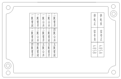

´úºÅ
¸½¼Ó¹¦ÄÜ
C1
M20¡Á1.5ÍâÂÝÎÆÑ¹Á¦½Ó¿Ú£¬¶ËÃæÃÜ·â
MPM460
C3
G1/2ÍâÂÝÎÆÑ¹Á¦½Ó¿Ú
C4
G1/4ÄÚÂÝÎÆÑ¹Á¦½Ó¿Ú
C5
M20¡Á1.5ÍâÂÝÎÆÑ¹Á¦½Ó¿Ú£¬Ë®ÏßÃÜ·â
MPM460
G
±íѹÐÍ
A
¾øÑ¹ÐÍ
S
ÃÜ·â±íѹÐÍ
P
ÆëƽĤÐÍ£¬G1/2ÍâÂÝÎÆÑ¹Á¦½Ó¿Ú
Jn
½ÓµãÊýn=1¡«5
V1
¹©µç24VDC
V2
¹©µç220VAC
