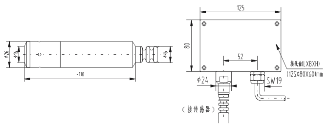

•·ÖÌåʽ½á¹¹£¬Í¶Èë(²åÈë)ÒºÌåÖеĴ«¸ÐÆ÷²¿·ÖΪȫÃÜ·â²»Ðâ¸Ö½á¹¹£¬µç×ÓÏß·¿ÇÌåΪÖýÂÁ½á¹¹¼þ£¬°²×°ÓÚ·½±ã½ÓÏߵĵط½£¬±ãÓÚµ÷УºÍ½ÓÏߣ»
•MPM416WRKÐÍΪȫº¸½Ó£¬²»Ðâ¸ÖÈáÐÔÈí¹Üîø×°£»

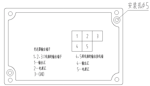

´«Ê䷽ʽ
¶þÏß
ÈýÏß
ÈýÏß
µçÔ´µçѹ
15¡«28VDC(±¾°²Ð;­°²È«Õ¤¹©µç)
15¡«28VDC
15¡«28VDC

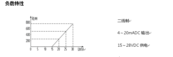

Êä³öÐźÅ
4¡«20mADC
0¡«10/20mADC
0/1¡«5/10VDC
¸ºÔØ(¦¸)
£¼(U-15)/0.02A
£¼(U-15)/0.02A
£¾5k
