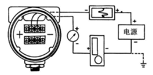

      ¹©µçµçÔ´£º ¹©µçµçԴΪ12¡«45VDC £¬´øÊý×ÖÏÔʾÆ÷Ϊ15¡«¡«45VDC £¬Ò»°ã¹¤×÷µçԴΪ24VDC¡£
      ¸º      ÔØ£º Ó빩µçµçÔ´Óйأ¬¸ºÔØ×迹RÓëµçÔ´µçѹV¹ØÏµÊ½ÎªR¡Ü50(V-12)¦¸¡£´øLCDÊý×ÖÏÔʾÆ÷µÄ¸ºÔØRÓëV¹ØÏµÊ½ÎªR¡Ü50(V-15)¦¸
