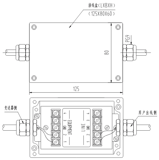

¡¡¡¡PD100ÐÍ·ÀÀ×±£»¤Æ÷ÊÇΪÁËÔ¤·À±äËÍÆ÷ÔÚÀ׵硢¾²µç·ÅµçµÈ»·¾³Öа²È«Ê¹ÓöøÉè¼ÆµÄ¡£Ëü¿ÉÒÔÓÃÓÚ±äËÍÆ÷µç·¡¢ÐźÅÏß¡¢Êý¾ÝÏß¡¢¿ØÖƵç·¡¢¶¨Ê±µç·µÄ±£»¤¡£ÊÊÓÃÓÚ×ÔÀ´Ë®¡¢Ë®µç¡¢Ò±½ðµÈÐÐÒµ´«¸ÐÆ÷¡¢±äËÍÆ÷µÄ²âÁ¿ÖС£
•רΪ4¡«20mAµçÁ÷»ØÂ·Éè¼Æ£»
•¾ßÓÐ×Ô¸´Î»¹¦ÄÜ£»
•¾ßÓÐÁ½¼¶±£»¤£»
•¾ßÓÐÏߵغÍÏßÏß±£»¤(¹²Ä£ºÍ²îÄ£)£»
•ÏìӦʱ¼ä¿ì£»
•ÓÐЧÒÖÖÆÉÁµç¡¢¸ÐÓ¦¿ª¹ØºÍ¾²µç·Åµç¶Ô±äËÍÆ÷µÄË𺦣»
•Íâ¿Ç·À»¤µÈ¼¶¿É´ïIP65¡£
¼¼Êõ²ÎÊý
•×î´ó¹¤×÷µçÁ÷£º100mA
•ʹÓÃζȣº-55¡æ¡«100¡æ
•×î´ó˲ʱµçѹ£º6kV
•×î´ó·ÅµçµçÁ÷(8/20us)£º10kA/Ïß
¹æ¸ñÐͺŠ
¹æ¸ñ
µçÆøÌØÐÔ(»·¾³Î¶È25¡æ)
×î´ó¹¤×÷µçѹ
(¡ÀV)
×î´ó©µçÁ÷
(uA)
×î´óóéλµçѹ(V)
(8/20us)@2000A
×î´óµçÈÝ(pF)@0V,1MHz
×î´óÏßµç×è
PD100-V28
28.0
5.0
40
2800
12
PD100-V35
35.0
5.0
60
1500
12
PD100-V60
60.0
5.0
85
1000
12
×¢ÒâÊÂÏî
1¡¢±£»¤Æ÷Ó¦¾¡¿ÉÄܰ²×°ÔÚ¿¿½ü±»±£»¤µÄÉ豸»ò±äËÍÆ÷¶Ë¡£
2¡¢±£Ö¤ÏµÍ³½ÓµØÁ¼ºÃ¡£
