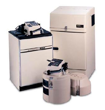

American Sigma900¼°900MAXÐÍϵÁвÉÑùÆ÷
¹þÏ£¹«Ë¾ÌṩµÄAmerican Sigma900¼°900MAXÐÍϵÁвÉÑùÆ÷£¬¾ßÓÐÏȽøµÄ¼¼ÊõºÍÓÅÖʵĿͻ§·þÎñ£¬ÆäÓµÓпͻ§Ëù¹Ø×¢µÄ¾«È·ÐÔ¡¢¼òµ¥ÐÔ¡¢Áé»îÐÔ¡¢¿É¿¿ÐÔ¼°¾­¼ÃÐÔ¡£900ÐͲÉÑùÆ÷ÊÊÓÃÓÚ¶¨Ê±µÈ¼ä¸ôµÈÌå»ý²ÉÑù£¬¼°Á÷Á¿±ÈÀý²ÉÑù£»900MAXÐͲÉÑùÆ÷¿ÉÂú×ã¸ü¸ßµÄ²ÉÑùÒªÇó£¬Èç¼à²âÓêË®¨DÎÛË®ºÏÁ÷µÄÏÂË®µÀµÄÒçÁ÷£¬¼à²â±©ÓêÅÅË®¿Ú£¬½øÐÐÉúÎï¼à²â£¬»òÕßÊǽøÐÐË®ÖÊÑо¿µÈ¡£American Sigma900ÐͺÍ900MAXÐͶ¼ÓбãЯʽ²ÉÑùÆ÷¡¢Àä²ØÊ½²ÉÑùÆ÷ºÍÈ«Ììºò²ÉÑùÆ÷ÈýÖÖÉè¼Æ¡£
±ãЯʽ²ÉÑùÆ÷£¬ÖØÁ¿½ö28°õ£¬ËùÅäµÄÌáÉýÊÖ±ú±ãÓڰᶯ¡£¸ù¾Ý²ÉÑùÒªÇ󣬿ÉÒÔÅäÖóɵ¥Æ¿»ò¶àÆ¿²ÉÑù¡£ÅäÓÐÒ»¸ö¿É»¥»»µÄ½ô´ÕÐ͵××ù¼°±ê×¼³ß´çµ××ù£¬½ô´ÕÐ͵××ùµÄÉè¼ÆÊÇΪÁËÔÚ18Ó¢´çµÄÏÂË®µÀ¼ìÐÞ¿Ú½øÐвÉÑùʱʹÓ㬿ÉÒÔ×°8-1/2lbs.ÖØµÄ±ùºÍ24¸ö575mlµÄÆ¿×Ó£»±ê×¼ÐÍ»ù×ù¿ÉÒÔ×°32lbs.ÖØµÄ±ùºÍ24¸ö350mlµÄÆ¿×Ó£¬²ÉÑùÆ÷µÄdzÃ×É«ÓÐÖúÓÚ·´ÉäÑô¹â£¬Ê¹±ù¿éµÄ±£´æÊ±¼ä¸ü³¤¡£ÊÕ¼¯ºóµÄÑùÆ·ÔÚË«²ã¾øÈÈ»ù×ùÖб£´æ£¬Ò»Ö±±£³ÖµÍΡ£´ËÍ⣬ÔÚÏÖ³¡¿ÉÒÔ·½±ãµØ½ø ÐвÉÑùÆ÷²ÎÊýµÄÉèÖá£
Àä²ØÊ½²ÉÑùÆ÷ÔÚÏÖ³¡¹Ì¶¨Ê¹Óã¬ÄÜÔÚ³±ÊªºÍ¸¯Ê´µÄ»·¾³ÏÂÕý³£¹¤×÷¡£ÖÆÀä»úΪ²»Ðâ¸Ö²ÄÁÏ¡£Í¨¹ý¿ÕÆø¸ÐӦζȵ÷½Ú¿ØÖÆÀ䲨ζȣ¬¸ßЧѹËõ»ú¡¢ÀäÄýÆ÷¡¢Õô·¢Æ÷ºÍÑÏÃܵÄÅÝÄ­ËÜÁϸôÀë×°Öñ£Ö¤×î¼ÑµÄ4¡æË®Ñùζȡ£Ç¿ÖÆ¿ÕÆø´µÉ¨ºÍǰ²¿Í¨·çʹµÃ²ÉÑùÆ÷¿ÉÒÔÁé»îµØ°²·ÅÔÚǽÅԱߣ¬»òÕßÊDzÉÑùÆ÷ÍâÕÖÖС£¼üÅÌ¡¢¿ª¹Ø¡¢ÏÔʾÆÁ¶¼¾ßÓзÀË®¡¢·À¸¯Ê´¹¦ÄÜ£¬ÃÜ·âµÄÁ¬½Ó¼þºÍ±ÃÖá±£Ö¤Á˲ÉÑùÆ÷²»ÊÜËù´¦»·¾³µÄÓ°Ïì¡£
È«ÌìºòÀ䲨²ÉÑùÆ÷£¬Äܹ»±£Ö¤Ë®ÑùµÄ±£´æÎ¶ÈÔÚ4¡æ¡£Ñ¹Ëõ»ú·ÅÔÚÁ˲ÉÑùÆ÷µÄ¶¥¶Ë£¬¿É±ÜÃâÁò»¯ÇâºÍÆäËû±È¿ÕÆøÖØµÄ¸¯Ê´ÐÔÆøÌå¶ÔÆäÔì³ÉµÄË𺦡£²ÉÑùÆ÷Å䱸µÄ¸ßÇ¿¶È¡¢¿¹»¯Ñ§¸¯Ê´µÄÍâÕÖ£¬ÄܸüºÃµØ±£»¤ÖÆÀä¹ÜÏß²»Êܳ±ÊªºÍ¸¯Ê´ÆøÌåµÄÇÖº¦¡£ÏµÍ³µÄ¸ÐÓ¦Æ÷ͨ¹ý¶ÔÕô·¢Æ÷µÄζȡ¢»·¾³¿ÕÆøµÄζȡ¢ÑùÆ·ÒºÌåµÄζȵÄÁ¬Ðø¼à²â£¬ÓÉ΢´¦ÀíÆ÷¿ØÖÆË®ÑùÊÒµÄÉýΡ£È«ÌìºòÀä²ØÊ½Ë®ÖʲÉÑùÆ÷ÌṩµÄÊǶԻ·¾³ÎÞº¦µÄ¡¢²»º¬·úÀï°ºµÄÖÆÀä¼Á¡£
ÑùÆ·µÄ´ú±íÐÔÓëÕæÊµÐÔ
Ë®ÖʲÉÑùµÄ×î»ù±¾ÒªÇóÊÇÔÚˮϵͳÖлñÈ¡Óдú±íÐÔµÄË®Ñù£¬Ê¹ÓÃAmercian SigmaϵÁвÉÑùÆ÷£¬¿ÉÒÔ»ñµÃË®ÖʹÜÀíËùÒªÇóµÄ׼ȷ¡¢¿ÉÔÙÏÖÊý¾Ý£¬²¢¿ÉÒÔËæÊ±Á˽âË®ÖÊ×´¿ö¡£
¿É¿¿µÄÈ䶯±Ã¼¼Êõ
American SigmaϵÁвÉÑùÆ÷ʹÓÃÕýÏàÎ»ÒÆÈ䶯±Ã£¬ÒÔ ¿¹¸¯Ê´µÄDelrin®£¨µü¶ûÁÖ£¬¼´¾Û¼×È©Ê÷Ö¬£©ÖƳɡ£±Ã¿¿¼·Ñ¹Ò»¸ö3/8in.ÄÚ¾¶Èí¹Ü£¬Ê¹Ë®Á÷½øÈë²ÉÑùÆ÷£¨Ö»ÓйÜ×ÓºÍÒºÌå½Ó´¥£©¡£American SigmaϵÁвÉÑùÆ÷ÄÜÔÚÄÚ¾¶3/8in.µÄÈë¿Ú¹ÜÏßÖУ¬ÔÚ3ft.µÄÌáÉý¾àÀëÄÚÌṩ3.3ft./secµÄÁ÷ËÙ¡£
ÏȽøµÄÒºÌå¼ì²â¼¼Êõ
·Ç½Ó´¥µÄ³¬Éù²¨ÒºÌå¸ÐӦϵͳÄܹ»±£Ö¤×¼È·µÄÈ¡ÑùÌå»ý ¼°²ÉÑùµÄÖØ¸´ÐÔ¡£ÓëѹÁ¦¸ÐӦϵͳÏà±È£¬ÔÚÒºÌåζȱ仯ºÜ ´óµÄÇé¿öÏ£¬·Ç½Ó´¥µÄ³¬Éù²¨ÒºÌå¸ÐӦϵͳÄܹ»Õý³£¹¤×÷¡£´ËÍ⣬·Ç½Ó´¥µÄ³¬Éù²¨ÒºÌå¸ÐӦϵͳ¿É±£Ö¤Ëù²É¼¯µÄÑùÆ·²»±»ÎÛȾ¡£ÀýÈ磬Èë¿Ú¹ÜÏßÔÚÿ´Î²ÉÑùǰºÍ²ÉÑùºó¶¼»á³¹µ×ÇåÏ´¡£ÎªÁ˱ÜÃâ½»²æÎÛȾ£¬¿ÉÒÔ·½±ãµØ½øÐйÜÏßÇåÏ´£¬±ãÓÚ²ÉÑùǰ£¬Èë¿ÚÄÜÔ¤Ïȱ»Ëù²ÉË®ÑùÔ¤´¦Àí¡£Èç¹ûÓÉÓÚÈë¿Ú¶ÂÈûʹµÃ²ÉÑù²»ÄÜÕý³£¹¤×÷£¬¸ÐÓ¦Æ÷ÄÜÁ¢¼´¼ì²âµ½¹ÊÕϲ¢ÇÒÁ¢¿Ì½øÐиßѹ¾»»¯£¬È»ºóÖØÐ¿ªÊ¼ÐÂÒ»ÂÖ²ÉÑù¡£American SigmaϵÁвÉÑùÆ÷Äܱ£Ö¤²ÉÑùµÄ׼ȷÐÔºÍ×îСµÄʧÎó¡£
