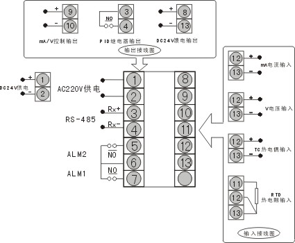

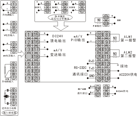

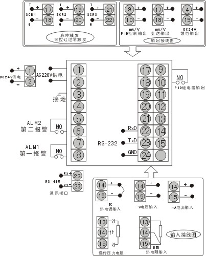

½ÓÏßͼ
±¸×¢ ÌØÊâ¶©»õÓë±¾½ÓÏßͼ²»Í¬Ö®´¦£¬ÒÔËæ»ú½ÓÏßͼΪ׼¡££¨ÊúʽÓëÉϽÓÏßͼһÖ£¬µ«·½Ïò²»Ò»Ñù£¬ÊúʽÒDZíÏò×óÄæÊ±ÕëÐýת90¡æ£¬Êúʽ¹âÖùÏòÓÒ˳ʱÕëÐýת90¡æ¡££©²»Í¬¹¦ÄÜÔÚͬһ¶Ë×ӵģ¬Ö»ÄÜÑ¡ÆäÖÐÒ»ÖÖ¹¦ÄÜ¡£
