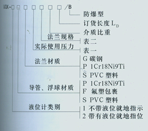

4¡¢UQK¸¡ÇòҺλ¼ÆÑ¡Ðͱí
±íÒ»
ʹÓÃѹÁ¦
MPa
0.6
1.0
1.6
2.5
4.0
6.3
´úºÅ
A
B
C
D
E
F
·¨À¼±ê×¼
HG20593-97£¨RF£©
HG20595-97£¨RF£©
±í¶þ
´úºÅ
A
B
C
D
DN
80
100
120
150
PN
±Èʵ¼ÊʹÓÃÌá¸ßÒ»¸öµÈ
