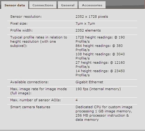

²úÆ·Ãû³Æ£º AT¹¤ÒµÏà»ú---C4-2350-GigE
ÐÍ ºÅ£º C4-2350-GigE
Non-contact 3D measurementin accordance with the laser-sheet of light (triangulation) method
Measuring speed up to 58 Millionen 3D-points per second (at 23450 Profile/s)
Dedicated CPU for custom image processing
1 GB image memory
Image processing integrated in the camera. Height profile output via GigE Vision
¡¤  Configurable camera modes: image mode, profile mode
¡¤  Selection of 3D camera algorithms: threshold-selection method, maximum method, COG method, peak method (customized algorithms),
¡¤  All algorithms achieve the maximum profile rate, regardless of the algorithm selected and its parameters
Simple configurationvia camera register
Configurable selection of the data output, e.g. height data or height data + intensity data
Programmable number of profiles that can be merged to form a height image
Up to 4 freely selectable AOIs (sensor read-out window) in image and profile mode
Configurable shutter-modes: rolling-shutter
Flexible trigger functions for profile and image triggering
RS422 interface converterwith programmable counter for profile trigger generation and integral identification of direction of movement
Data transmission via Gigabit Ethernet Interface
Configurable opto coupled I/Os for trigger function and synchronisation
Storage of a user-defined start-up camera configurationin a configuration EEprom
integrated control of extern illumination(Laser)
