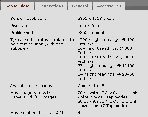

Non-contact 3D measurement in accordance with the laser-sheet of light (triangulation) method
Measuring speed up to 60 million 3D points per second (at 47000 profiles/s)
Image processing integrated in the camera. Height profile output via standard camera interfacee
Configurable camera modes: image mode, profile mode
Selection of 3D camera algorithms: threshold-selection method, maximum method, COG method
All algorithms achieve the maximum profile rate, regardless of the algorithm selected and its parameters
Simple configuration via camera register
Configurable selection of the data output, e.g. height data or height data + intensity data
Genuine global snapshot shutter for accurate profiles without movement distortion (blurring)
Programmable number of profiles that can be merged to form a height image
Up to 8 freely selectable AOIs (sensor read-out window) in image and profile mode
konfigurierbare shutter-modes: snapshot-shutter (sequential und interleaved), rolling-shutter
Flexible trigger functions for profile and image triggering
RS422 interface converter with programmable counter for profile trigger generation and integral identification of direction of movement
Data transmission via Camera Link™-Interface
Configurable opto coupled I/Os for trigger function and synchronisation
Storage of a user-defined start-up camera configurationin a configuration EEprom
