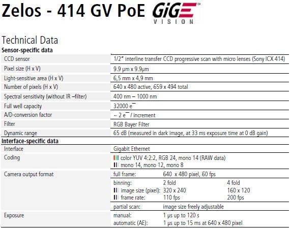

 It is fitted with the Sony IXC414 CCD sensor, monochrome or color, and provides VGA resolution at a frame rate of 60 fps (up to 200 fps with binning and partial scan). The GigE Vision interface (1 Gbit/s) with a stable waterproof connector assures safe data transfer. The camera is powered via Power-over-Ethernet (PoE).  The Zelos-414 features protection class IP54 and is thus protected against dust and splash. The typical Kappa quality characteristics regarding hardiness and durability make this camera one of the most rugged models in its class.
