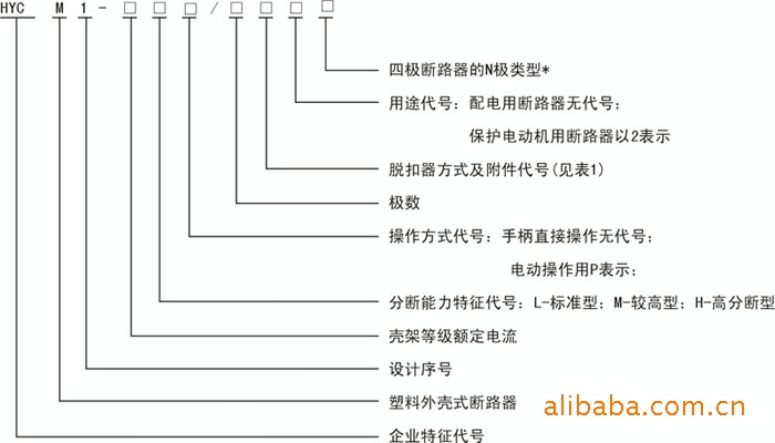

Ðͺź¬Òå¼°Æä·ÖÀà
Ðͺż°Æä·ÖÀà
×¢*£ºË﫲úÆ·ÖÐÐÔ¼«(N¼«)µÄÐÍʽ·ÖËÄÖÖ
AÐÍN¼«²»°²×°¹ýµçÁ÷ÍÑ¿ÛÔª¼þ£¬ÇÒN¼«Ê¼ÖÕ½Óͨ£¬²»ÓëÆäËüÈý¼«Ò»ÆðºÏ·Ö£»
BÐÍN¼«²»°²×°¹ýµçÁ÷ÍÑ¿ÛÔª¼þ£¬ÇÒN¼«ÓëÆäËüÈý¼«Ò»ÆðºÏ·Ö£»(N¼«ÏȺϺó·Ö)£»
CÐÍN¼«°²×°¹ýµçÁ÷ÍÑ¿ÛÔª¼þ£¬ÇÒN¼«ÓëÆäËüÈý¼«Ò»ÆðºÏ·Ö£»(N¼«ÏȺϺó·Ö)£»
DÐÍN¼«°²×°¹ýµçÁ÷ÍÑ¿ÛÔª¼þ£¬ÇÒN¼«Ê¼ÖÕ½Óͨ£¬²»ÓëÆäËüÈý¼«Ò»ÆðºÏ·Ö£»
