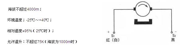

 ¶þ¡¢Ê¹ÓÃ˵Ã÷                                                                                             ½ÓÏß˵Ã÷
