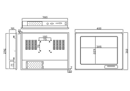

A°æ±¾³ß´çͼ£¨µ¥Î»£ºmm£©

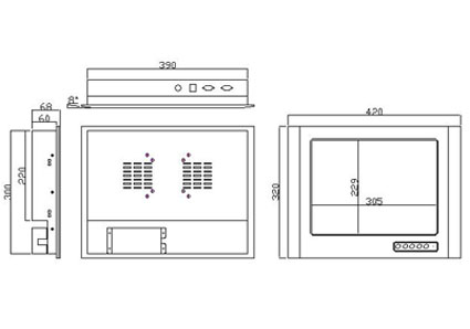

B°æ±¾³ß´çͼ£¨µ¥Î»:mm£©
