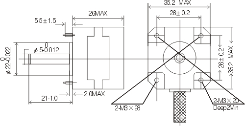

²úÆ·Ãû³Æ£º ²½½øµç»ú
ÐÍ ºÅ£º 35ϵÁÐ
ͨÓùæ¸ñ
²½¾à¾«¶È
+5%(Õû²½¡¢¿ÕÔØ)
ÎÂÉý
80¡ãCMax
»·¾³Î¶È
-10¡ãC -- +50¡ãC
¾øÔµµç×è
100M¦¸min.500VDC
ÄÍѹ
500VAC for one minute
¾¶ÏòÌø¶¯
0.06 Max.(450g-load)
ÖáÏòÌø¶¯
0.08 max.(450g-load)
¼¼Êõ¹æ¸ñ
Model No.
ÏàÊý
²½¾à½Ç
±£³Öת¾Ø
¶î¶¨µçÁ÷
Ïàµç¸Ð
Ïàµç×è
ÒýÏßÊýÁ¿
ת×Ó¹ßÁ¿
¶¨Î»×ª¾Ø
µç»úÖØÁ¿
»úÉí³¤
(¡ã)
N.M
A
mH
Ohm
g.cm2
Kg.cm
Kg
mm
35HS01
2
1.8
0.07
0.4
16
35
4
12
0.1
0.17
26
ÍâÐγߴç

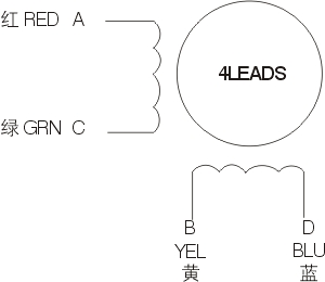

½ÓÏßͼ
