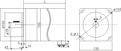

Öлª¹¤¿ØÍø ¡ú ¹¤¿Ø²úÆ· ¡ú ²½½øµç»ú
²úÆ·Ãû³Æ£º ²½½øµç»ú
ÐÍ ºÅ£º 130ϵÁÐ
ͨÓùæ¸ñ
²½¾à¾«¶È
+5%(Õû²½¡¢¿ÕÔØ)
ÎÂÉý
80¡ãCMax
»·¾³Î¶È
-10¡ãC -- +50¡ãC
¾øÔµµç×è
100M¦¸min.500VDC
ÄÍѹ
500VAC for one minute
¾¶ÏòÌø¶¯
0.06 Max.(450g-load)
ÖáÏòÌø¶¯
0.08 max.(450g-load)
¼¼Êõ¹æ¸ñ
Model No.
ÏàÊý
²½¾à½Ç
±£³Öת¾Ø
¶î¶¨µçÁ÷
Ïàµç¸Ð
Ïàµç×è
ÒýÏßÊýÁ¿
ת×Ó¹ßÁ¿
¶¨Î»×ª¾Ø
µç»úÖØÁ¿
»úÉí³¤
(¡ã)
N.M
A
mH
Ohm
Kg.cm2
Kg.cm
Kg
mm
130HS27
2
1.8
27
6
13.8
0.65
4
35
10
13
227
130HS33
2
1.8
33
6
7.2
0.72
4
35
10
13
227
130HS40
2
1.8
40
7
16.7
0.8
4
45.5
12
16
283
130HS45
2
1.8
45
7
9.5
0.9
4
48.4
16
19
283
*ÒÔÉϽöΪ´ú±íÐÔ²úÆ·
ÍâÐγߴç

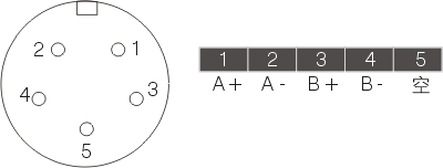

½ÓÏßͼ

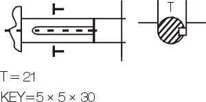

µç»úÖáÏêϸ²ÎÊý
