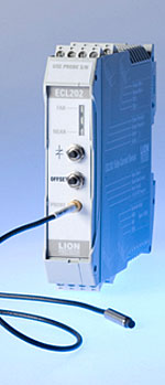

ECL202 ºÍ ECL203 µçÎÐÁ÷Î»ÒÆ´«¸ÐÆ÷
ECL202 µçÎÐÁ÷´«¸ÐÆ÷ÐÔÄÜ
  • ÏßÐÔ¶È£º ¡À0.2%
  • ECL202 ·Ö±æÂÊ£¨Ò»°ã£©£º0.006% F.S.£¨ÓÐÉ«½ðÊô£©£»0.008% F.S.£¨º¬Ìú½ðÊô£©
    £¨È¡¾öÓÚ̽ͷºÍ²âÁ¿·¶Î§£©
  • ECL203 ·Ö±æÂÊ£º0.3 ΢Ã× (RMS) »ò¸ü¸ß @15 kHz (RMS)
  • ´ø¿í£º15 kHz
  • 0-10 VDC Êä³ö

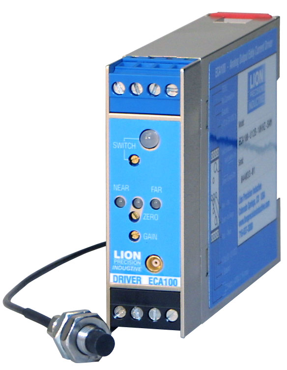

ECA101 µçÎÐÁ÷Î»ÒÆ´«¸ÐÆ÷
sdÐÔÄÜ
  • ·ÇÏßÐÔÊä³ö
  • ·Ö±æÂÊ£º0.02%FS
  • ´ø¿í£º10 kHz
  • 0-10 VDC Êä³ö
  • É趨µã¿ª¹ØÊä³ö
