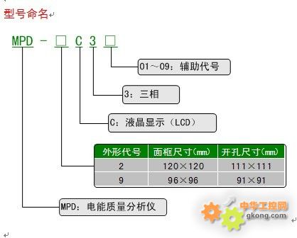

ÐÍ ºÅ£º MPD-9C300/MPD-9C301/MPD-2C300

ÍâÐγߴç
Ãæ¿ò³ß´ç£¨mm£©
120¡Á120; 96¡Á96
¿ª¿×³ß´ç£¨mm£©
111¡Á111; 91¡Á91
¹æ¸ñÑ¡ÐÍ
                       ÐͺÅ
  ¹¦ÄÜ
MPD-9C300
MPD-9C301
MPD-9C302
MPD-2C300
MPD-2C301
MPD-2C302
