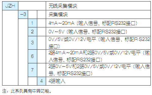

²úÆ·Ãû³Æ£º JZH-3ϵÁÐÎÞÏ߲ɼ¯Ä£¿é
ÐÍ ºÅ£º JZH-3**
Æ· ÅÆ£º 663
ϵÁмò½é¼°ËµÃ÷
²É¼¯¡¢´«ÊäÒ»Ì廯Éè¼Æ£¬ÖÇÄܹÜÀí¡¢ÖÇÄÜ´«Êä¡£´«Êä¾àÀëÔ¶£¬²ÉÓÃÎÞÏß2.4G zigbeeЭÒ飬¿¹¸ÉÈÅÄÜÁ¦¸üÇ¿¡£16ÎïÀíÐŵÀ¿ÉÑ¡£¬65535¸öÍøÂçID¿ÉÉ裬×éÍøÄÜÁ¦¸üÇ¿¡£ÊÊÓÃÓÚÊÒÄÚ»·¾³¡¢Å©Òµ´óÅïÖÇÄܹÜÀíµÈ¡£
²úÆ·ÌØµã
I´«Êä¾àÀëÔ¶£»
I¶àÖÖÑ¡ÔñÊäÈëÐźţ»
IÓѺõÄÈË»ú½çÃæ£¬·½±ã²Ù×÷£»
IZigBee×éÍø·½Ê½²ÉÓÃÍø×´Íø£»
IÍøÂçÈÝÁ¿´ó£¬2.4GHz16¸ö²»Í¬ÐŵÀ£»
IÊý¾ÝͨѶ²ÉÓÃÖ÷´Ó·½Ê½£»
IÊý¾Ý²É¼¯Áé»î£¬Ö÷¶¯Éϱ¨ºÍ²éѯӦ´ðÁ½ÖÖ·½Ê½¡£

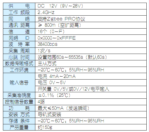

¼¼Êõ²ÎÊý
¹æ¸ñÑ¡ÐÍ
