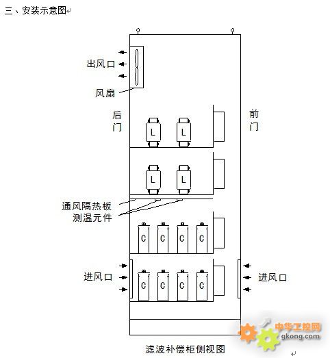

MGϵÁÐÎÞ¹¦²¹³¥Â˲¨×°ÖÃÊǽ«Ò»¶¨µç¿¹ÏµÊýµÄÂ˲¨µç¿¹Æ÷ºÍÒ»¶¨ÈÝÁ¿µÄÂ˲¨µçÈÝÆ÷½øÐÐÊʵ±±ÈÀýµØÅäÖã¬×é³ÉÂ˲¨»ØÂ·£¬´Ó¶ø´ïµ½ÎÞ¹¦²¹³¥¡¢µçÁ¦Â˲¨ºÍг²¨ÒÖÖÆµÄÄ¿µÄ¡£MGϵÁÐÎÞ¹¦²¹³¥Â˲¨×°ÖÃÓÉÂ˲¨µç¿¹Æ÷ºÍÂ˲¨µçÈÝÆ÷×é³É£¬²»º¬½Ó´¥Æ÷¡¢µ¶ÈÛ¿ª¹ØµÈÔªÆ÷¼þ¡£
ÐÔÄÜÌØµã
n ²úƷСÐÍ»¯£¬×°Öýṹ¼òµ¥£¬²ÎÊýµ÷ÕûÁé»î
n ×é×°Áé»î£¬×ÔÓɰ´ÐèÅäÖð²×°
n ¿É¸ù¾ÝÂ˲¨Ïûг»ò°²È«²¹³¥ÐèÒª½øÐе翹ϵÊýÑ¡Ôñ
n ²ÉÓÃ×ÔÓúʽµçÈÝÆ÷£¬²úÆ·¿É¿¿ÐÔ¸ß
n ÒÖÖÆ3¡¢5¡¢7¡¢9´ÎµÈг²¨£¬±ÜÃâгÕñ
n ͨÐÐÐÔÇ¿£¬ÊÊÓÃÓÚ¸÷ÖÖµçÈݲ¹³¥¹ñ£¬ÅäÌ×·½±ã
n µçÈÝÆ÷²ÉÓÃ9µm½ðÊô¾Û±ûÏ©±¡Ä¤£¬Ê¹½éµçÇ¿¶ÈºÍµçÈõµãÔ¶¸ßÓÚÐÐÒµÖÐͬÀà²úÆ·£¬±£Ö¤ÁËÔËÐеݲȫ¿É¿¿¡£
n ÊÊÓÃÓÚ400VµçÁ¦ÏµÍ³£¬ÈýÏ࣬¡÷½Ó·¨
×¢£ºµç¿¹ÏµÊýÊÇͨ¹ýµç¿¹Æ÷¸Ð¿¹ºÍµçÈÝÆ÷ÈÝ¿¹µÄºÏÀíÑ¡Å䣬ʹÎÞ¹¦²¹³¥Â˲¨×°ÖÃÔÚ»ù²¨ÆµÂÊϳÊÏÖΪÈÝÐÔ£¬²¹³¥ÎÞ¹¦£»ÔÚг²¨ÆµÂÊϳÊÏÖ¸ÐÐÔ£¬×î´ó³Ì¶ÈµØ½µµÍÁËгÕñµÄΣÏÕ£¬²¢ÓÉÓÚÆäµÍ×迹ÐÔ£¬ÓÐЧµØÒÖÖÆ²¢Â˳ýг²¨¡£
µç¿¹ÏµÊýµÄÑ¡Ôñ£ºÕë¶Ô3´Îг²¨£¬¿ÉÑ¡Ôñ12.5%£»¶ÔÓÚ5¡¢7´Î¼°ÒÔÉϸߴÎг²¨£¬¿ÉÑ¡Ôñ5.5%£»½ÏÉÙг²¨¿ÉÑ¡Ôñ7%×öΪ°²È«²¹³¥¡£

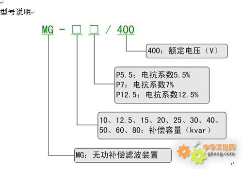

¹æ¸ñÑ¡ÐÍ
ÐͺŠ|
²¹³¥ÈÝÁ¿£¨kVar£© |
×éºÏ·½Ê½ |
µçÈÝÆ÷ÐͺŠ|
µç¿¹Æ÷ÐͺŠ|
MG-10P5.5/400 |
10 |
PFC-10-480-3P |
FR-10/400-5.5% |
MG-12.5P5.5/400 |
12.5 |
PFC-12.5-480-3P |
FR-12.5/400-5.5% |
MG-15P5.5/400 |
15 |
PFC-15-480-3P |
FR-15/400-5.5% |
MG-20P5.5/400 |
20 |
PFC-20-480-3P |
FR-20/400-5.5% |
MG-25P5.5/400 |
25 |
PFC-25-480-3P |
FR-25/400-5.5% |
MG-30P5.5/400 |
30 |
PFC-30-480-3P |
FR-30/400-5.5% |
MG-40P5.5/400 |
40 |
PFC-20-480-3P¡Á2£¨Ì¨£© |
FR-40/400-5.5% |
MG-50P5.5/400 |
50 |
PFC-25-480-3P¡Á2£¨Ì¨£© |
FR-50/400-5.5% |
MG-60P5.5/400 |
60 |
PFC-30-480-3P¡Á2£¨Ì¨£© |
FR-60/400-5.5% |
MG-80P5.5/400 |
80 |
PFC-20-480-3P¡Á4£¨Ì¨£© |
FR-80/400-5.5% |
MG-10P7/400 |
10 |
PFC-10-480-3P |
FR-10/400-7% |
MG-12.5P7/400 |
12.5 |
PFC-12.5-480-3P |
FR-12.5/400-7% |
MG-15P7/400 |
15 |
PFC-15-480-3P |
FR-15/400-7% |
MG-20P7/400 |
20 |
PFC-20-480-3P |
FR-20/400-7% |
MG-25P7/400 |
25 |
PFC-25-480-3P |
FR-25/400-7% |
MG-30P7/400 |
30 |
PFC-30-480-3P |
FR-30/400-7% |
MG-40P7/400 |
40 |
FR-40/400-7% |
MG-50P7/400 |
50 |
FR-50/400-7% |
MG-60P7/400 |
60 |
FR-60/400-7% |
MG-80P7/400 |
80 |
FR-80/400-7% |
MG-10P12.5/400 |
10 |
PFC-10-525-3P |
FR-10/400-12.5% |
MG-12.5P12.5/400 |
12.5 |
PFC-12.5-525-3P |
FR-12.5/400-12.5% |
MG-15P12.5/400 |
15 |
PFC-15-525-3P |
FR-15/400-12.5% |
MG-20P12.5/400 |
20 |
PFC-20-525-3P |
FR-20/400-12.5% |
MG-25P12.5/400 |
25 |
PFC-25-525-3P |
FR-25/400-12.5% |
MG-30P12.5/400 |
30 |
PFC-30-525-3P |
FR-30/400-12.5% |
MG-40P12.5/400 |
40 |
PFC-20-525-3P¡Á2£¨Ì¨£© |
FR-40/400-12.5% |
MG-50P12.5/400 |
50 |
PFC-25-525-3P¡Á2£¨Ì¨£© |
FR-50/400-12.5% |
MG-60P12.5/400 |
60 |
PFC-30-525-3P¡Á2£¨Ì¨£© |
FR-60/400-12.5% |
MG-80P12.5/400 |
80 |
PFC-20-525-3P¡Á4£¨Ì¨£© |
FR-80/400-12.5% |

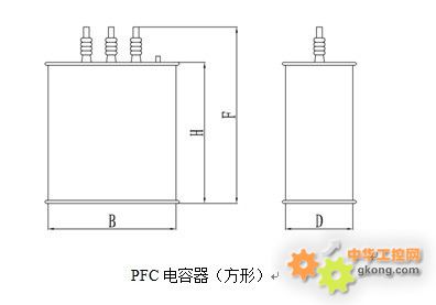

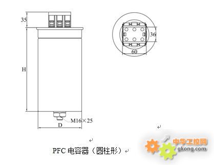

PFCµçÈÝÆ÷³ß´ç£¨Ô²ÖùÐΣ©
ÐͺŠ|
¶î¶¨µçѹ£¨V£© |
¶î¶¨ÈÝÁ¿£¨kVar£© |
ÍâÐγߴ禵D¡ÁH£¨mm£© |
°²×°·½Ê½ |
PFC-10-480-3P |
480 |
10 |
96*240 |
M16*25ÂÝ˨ |
PFC-12.5-480-3P |
480 |
12.5 |
96*240 |
M16*25ÂÝ˨ |
PFC-15-480-3P |
480 |
15 |
96*240 |
M16*25ÂÝ˨ |
PFC-20-480-3P |
480 |
20 |
116*240 |
M16*25ÂÝ˨ |
PFC-25-480-3P |
480 |
25 |
106*290 |
M16*25ÂÝ˨ |
PFC-30-480-3P |
480 |
30 |
116*290 |
M16*25ÂÝ˨ |
PFC-10-525-3P |
525 |
10 |
96*240 |
M16*25ÂÝ˨ |
PFC-12.5-525-3P |
525 |
12.5 |
96*240 |
M16*25ÂÝ˨ |
PFC-15-525-3P |
525 |
15 |
96*240 |
M16*25ÂÝ˨ |
PFC-20-525-3P |
525 |
20 |
116*240 |
M16*25ÂÝ˨ |
PFC-25-525-3P |
525 |
25 |
116*290 |
M16*25ÂÝ˨ |
PFC-30-525-3P |
525 |
30 |
116*290 |
M16*25ÂÝ˨ |
PFCµçÈÝÆ÷³ß´ç£¨·½ÐΣ©
ÐͺŠ|
¶î¶¨µçѹ£¨V£© |
¶î¶¨ÈÝÁ¿£¨kVar£© |
ÍâÐγߴç |
°²×°·½Ê½ |
³¤£¨B£© |
¿í£¨D£© |
¸ß£¨H£© |
×ܸߣ¨F£© |
PFC-10-480-3P |
480 |
10 |
170 |
70 |
220 |
270 |
M12¡Á16 |

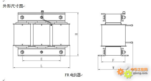

FRµç¿¹Æ÷³ß´ç
ÐͺŠ|
µç¿¹ÏµÊýP£¨%£© |
ÍâÐγߴçL¡ÁW¡ÁH£¨mm£© |
°²×°³ß´çE¡ÁF£¨mm£© |
FR-10/400-5.5% |
5.5 |
210X135X135 |
160X80 |
FR-12.5/400-5.5% |
5.5 |
210X145X135 |
160X90 |
FR-15/400-5.5% |
5.5 |
210X150X135 |
160X90 |
FR-20/400-5.5% |
5.5 |
240¡Á160¡Á155 |
200¡Á100 |
FR-25/400-5.5% |
5.5 |
240¡Á170¡Á165 |
200¡Á110 |
FR-30/400-5.5% |
5.5 |
270¡Á175¡Á170 |
220¡Á110 |
FR-40/400-5.5% |
5.5 |
270¡Á185¡Á170 |
220¡Á120 |
FR-50/400-5.5% |
5.5 |
300¡Á205¡Á190 |
250¡Á125 |
FR-60/400-5.5% |
5.5 |
300¡Á195¡Á240 |
250¡Á125 |
FR-80/400-5.5% |
5.5 |
300¡Á195¡Á260 |
250¡Á120 |
FR-10/400-7% |
7 |
210¡Á145¡Á135 |
160¡Á90 |
FR-12.5/400-7% |
7 |
240¡Á160¡Á155 |
200¡Á100 |
FR-15/400-7% |
7 |
240¡Á160¡Á155 |
200¡Á100 |
FR-20/400-7% |
7 |
240¡Á170¡Á155 |
200¡Á110 |
FR-25/400-7% |
7 |
270¡Á175¡Á170 |
220¡Á110 |
FR-30/400-7% |
7 |
270¡Á190¡Á170 |
220¡Á120 |
FR-40/400-7% |
7 |
300¡Á190¡Á190 |
250¡Á120 |
FR-50/400-7% |
7 |
300¡Á190¡Á250 |
250¡Á115 |
FR-60/400-7% |
7 |
300¡Á190¡Á260 |
250¡Á120 |
FR-80/400-7% |
7 |
330¡Á215¡Á265 |
280¡Á145 |
FR-10/400-12.5% |
12.5 |
200¡Á145¡Á245 |
160¡Á90 |
FR-12.5/400-12.5% |
12.5 |
245¡Á150¡Á245 |
205¡Á100 |
FR-15/400-12.5% |
12.5 |
245¡Á160¡Á215 |
205¡Á110 |
FR-20/400-12.5% |
12.5 |
245¡Á175¡Á210 |
205¡Á120 |
FR-25/400-12.5% |
12.5 |
245¡Á190¡Á210 |
205¡Á130 |
FR-30/400-12.5% |
12.5 |
305¡Á185¡Á235 |
265¡Á130 |
FR-40/400-12.5% |
12.5 |
305¡Á205¡Á240 |
265¡Á140 |
FR-50/400-12.5% |
12.5 |
305¡Á220¡Á260 |
265¡Á150 |
FR-60/400-12.5% |
12.5 |
340¡Á215¡Á285 |
300¡Á140 |
FR-80/400-12.5% |
12.5 |
320¡Á215¡Á355 |
280¡Á150 |
