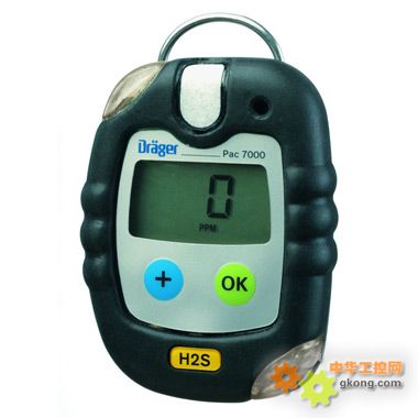

pac7000µÂ¶û¸ñÆøÌå¼ì²âÒÇÍâÐÎС¡¢¼á¹ÌÄÍÓᢷûºÏÈËÌ幤³ÌѧµÄÓѺÃÉè¼Æ¡¢Ö±¹Û¡¢¾­¼ÃʵÓᢹ¦ÄÜÇ¿´óµÄPac 7000ÊÇΪ¹¤×÷³¡Ëù¸öÈ˼໤¶øÁ¿Éí¶¨×öµÄ²úÆ·¡£ÕâÖÖ´´ÐÂµÄÆøÌå¼ì²âÆ÷Å䱸Á˸÷ÖÖ¹¦ÄÜ£¬²¢ÇÒÊʺÏÓÃÓÚÈÕ³£¹¤ÒµÉú²ú»·¾³Öи÷ÖÖ²»Í¬µÄÓÃ;¡£µÂ¶û¸ñPac7000Êǹ¦Äܷdz£ÓÅÒìµÄ¹¤¾ß£¬¾ßÓкܸߵĿɿ¿ÐÔ£¬µÂ¶û¸ñPac7000Äܹ»¿ìËÙÔ¤¾¯Ò»Ñõ»¯Ì¼£¬Áò»¯Ç⣬ÑõÆø£¬¶þÑõ»¯Ì¼£¬ÂÈÆø£¬ÇâÇèËᣬ¶þÑõ»¯µª£¬Á×»¯ÇâºÍ¶þÑõ»¯ÁòµÄÓк¦Å¨¶È¡£
        µÂ¶û¸ñPac7000ÊÇһ̨ÓÃÓÚ¸öÈË·À»¤µÄÐÂÐ͵¥Ò»ÆøÌå¼ì²â±¨¾¯ÒÇ£¬¿ÉÒÔÁ¬Ðø¼ì²â»·¾³¿ÕÆøÖеÄÏà¹Ø¶¾ÆøµÄŨ¶È²¢¼°Ê±±¨¾¯¡£
Pac7000 µ¥Ò»ÆøÌå¼ì²âÒÇÓÐÈçÏÂÌØµã£º
ÍâÐÎСÇÉ£¬¼á¹ÌÄÍÓÃ
        µÂ¶û¸ñPac7000ÎÞÂ۴ӳߴçºÍÖØÁ¿À´Ëµ£¬¶¼·Ç³£ÊÊÓÃÓÚ¸öÈË·À»¤¡£ÒÇÆ÷ÍⲿÓÐÒ»²ãÏð½ºÊ¹µÃÒÇÆ÷¸ü¼á¹ÌÄÍÓÃÇÒ·À»¤µÈ¼¶ÎªIP65¡£±³ÃæÅäÓеÄÑü´ø¼Ð¿É½«ÒÇÆ÷±ðÔÚʹÓÃÕߵŤ×÷·þÉÏ¡£
ʹÓ÷½±ã
        µÂ¶û¸ñPac7000Ë«¼üʽ²Ù×÷Ãæ°å£¬Ê¹Óüòµ¥·½±ã£¬¿ÉÒÔͨ¹ýËø¶¨°´¼ü±ÜÃâÎó²Ù×÷¡£¸ü»»ï®µç³Ø¿ìËÙ¼òµ¥¡£Í¨¹ýºìÍâ½Ó¿ÚºÍרÓÃÈí¼þ£¬¿ÉÔÚ¼ÆËã»úÉ϶ÔÒÇÆ÷½øÐÐÅäÖúͱ궨¡£
´óÆÁÄ»ÏÔʾ
        ´óÆÁÄ»ÏÔʾÄܹ»ÊµÊ±ÏÔÊ¾ÆøÌåŨ¶ÈÖµ£¬¾¯¸æºÍ¹ÊÕÏ£¬¼°ÒÇÆ÷µÄÊ£ÓàʹÓÃʱ¼ä£¬ÇÒÅäÓÐÃ÷ÁÁµÄ±³¾°¹âÕÕÃ÷¡£
´´ÐµĴ«¸ÐÆ÷¼¼Êõ
      µÂ¶û¸ñPac7000ʹÓà µÂ¶û¸ñÐÂÐÍXXS´«¸ÐÆ÷Êǵ绯ѧ¼ì²âÔ­Àí£¬À©É¢¾àÀë¶Ì£¬·´Ó¦ÁéÃôѸËÙ¡£
´«¸ÐÆ÷¸ü»»·½±ã¡£
¹¦ÄܲâÊÔģʽ
       pac7000µÂ¶û¸ñÆøÌå¼ì²âÒǵ¥Ò»ÆøÌå¼ì²âÒÇÅäÓй¦ÄܲâÊÔģʽ£¬µ±ÐèҪͨ¹ý¹¦ÄܲâÑé¼ì²é±ê¶¨Çé¿öʱ£¬ÏÔʾÆÁÉÏ»á³öÏÖÒ»¸ö¾¯¸æÍ¼±ê¡£Óû§¿ÉÒÔµ÷Õû¹¦ÄܲâÊÔÖÜÆÚ¡£¹¦ÄܲâÊԼȿÉÒÔÊÖ¹¤Íê³É£¬Ò²¿ÉÒÔͨ¹ýÈí¼þÍê³É¡£¹¦ÄܲâÊÔ×é¼þ¿ÉÑ¡Å䣬ͨ¹ýÈí¼þPac Vision»òCC Vision£¬µÂ¶û¸ñPac7000¿ÉÒÔ¼¤»î²¢½øÐй¦ÄܲâÊÔ¡£¹¦ÄܲâÊÔ½á¹û»á´¢´æÔÚʱ¼ä´æ´¢Æ÷Àï¡£
ʹÓÃʱ¼ä¿Éµ÷
        µÂ¶û¸ñPac7000µÄʹÓÃʱ¼ä¿ÉÒÔµ÷Õû£¬ÀýÈçµ÷Õû±ê¶¨ÖÜÆÚ£¬¼ì²éÖÜÆÚ»òÌØÊâµÄ¡°ÊÙÃüÖÜÆÚ¡±¡£ÕâЩµ÷Õû¿ÉÒÔͨ¹ýÈí¼þPac Vision»òCC VisionÍê³É¡£
ʼþ´æ´¢Æ÷
        µÂ¶û¸ñPac 7000ÅäÓÐʱ¼ä´æ´¢Æ÷£¬¿ÉÒÔ´¢´æÎåÌì7200¸öÊý¾Ý¡£Í¨¹ýÈí¼þPac Vision£¬CC Vision»òGas Vision¿ÉÒÔ½«´¢´æµÄÊý¾Ý´«Êäµ½¼ÆËã»úÀ²¢½øÐб༭¡£
±¨¾¯/¾¯¸æ¹¦ÄÜ
        Äú²»ÓÃÔÙΪàÐÔÓ»ò¹ýÓÚÃ÷ÁÁµÄ¹¤×÷»·¾³ÖÐʱ¿Ì×¢ÒâÒÇÆ÷ÊÇ·ñ±¨¾¯¶øµ£ÐÄÁË£¡µÂ¶û¸ñPac7000¾ßÓÐÉù¹â¼°Õñ¶¯±¨¾¯¡£±¨¾¯ÎªË«ÉùÃùÏ죬Ò×ÓÚʶ±ð¡£ÁíÍ⣬µÂ¶û¸ñPac7000ÊÙÃü½«¾¡Ê±»òµç³ØÊÙÃü½«¾¡Ê±¶¼»á¼¤»î±¨¾¯¹¦ÄÜ¡£Ô¤±¨¾¯ºÍÖ÷±¨¾¯ÊÇ¿ÉÒÔÑ¡ÔñÊÇ·ñÈ·ÈÏ»òËø¶¨µÄ¡£
±ê¶¨ºÍÒÇÆ÷Åä¼þ
        µÂ¶û¸ñPac 7000¿ÉÒÔͨ¹ýºìÍâͨѶ½Ó¿Ú»òE-Cal±ê¶¨×é¼þÓë¼ÆËã»úÁ¬½Ó£¬Í¨¹ýPac Vision»òCC VisionÈí¼þ£¬¶ÔÒÇÆ÷½øÐб궨»òËùÓй¦ÄܵĸöÐÔ»¯ÅäÖã¬ÒÔ¼°´«Êä´æ´¢Êý¾Ý¡£
µÂ¹úµÂ¶û¸ñPac7000 µ¥Ò»ÆøÌå¼ì²âÒǼ¼Êõ²ÎÊý
³ß´ç£¨³¤¡Á¿í¡Á¸ß£©£º 64¡Á84¡Á20mm
ÖØÁ¿£º120g
»·¾³Ìõ¼þ£º  ζȣº-30¡«50¡æ
ѹÁ¦£º700¡«1300 hPa
ʪ¶È£º10¡«90% r. h.
·À»¤µÈ¼¶£ºIP65
ÏÔʾ£ºÏÔʾ±»²âÆøÌåÖÖÀ࣬ÒÇÆ÷ÊÙÃü£¬¾¯¸æºÍ¹ÊÕϹ¦ÄÜ£¬ÊµÊ±ÏÔÊ¾ÆøÌåŨ¶ÈÖµ
µç³ØÊÙÃü£¨25¡æÊ±£¬Ã¿Ì칤×÷24Сʱ£©£º
            CO£º>5500Сʱ
            H2S£º>5500Сʱ
            O2£º>2700Сʱ
±¨¾¯£ºË«ÉùÃùÏ죬>90dB£¨A£©£¬ÔÚ30cm·¶Î§ÄÚ
ÈÏÖ¤£ºCE-Sign£º£¨89/336/EEC£¬94/9/EC£©
          ATEX£ºI/II M 1/1 G EEx ia I/IIC, T4
                        -30¡æ ¡Ü Ta ¡Ü +55¡æ
            UL£º  Class I, II Div 1, Group A, B, C, D, E, F, G, Temp. Code T4
            Cul£º  Class I, II Div 1, Group A, B, C, D, E, F, G, Temp. Code T4
Á¿³Ì¼°±¨¾¯Öµ£º
                                ²âÁ¿·¶Î§          A1±¨¾¯Å¨¶ÈÖµ        A2±¨¾¯Å¨¶ÈÖµ
Pac 7000 CO        0¡«1999ppm          30ppm                      60ppm
Pac 7000 H2S    0¡«100ppm            10ppm                      20ppm
Pac 7000 O2          0¡«25Vol.%          19 Vol.%                  23Vol.%
Pac7000CO2        0-5Vol%
Pac7000CL2          0-20ppm
Pac7000HCN        0-50ppm
Pac7000NH3          0-300ppm
Pac7000NO2          0-50ppm
Pac7000PH3          0-20ppm
Pac7000SO2          0-100ppm
