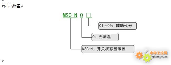

²úÆ·Ãû³Æ£º ·ðɽÃÀ¸ßÁ¢MSC-N¿ª¹Ø×´Ì¬ÏÔʾÆ÷MECELL
ÐÍ ºÅ£º MSC-N001/MSC-N002/MSC-N003/MSC-N004
