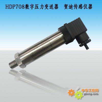

²úÆ·Ãû³Æ£º MODBUSЭÒéÊý×Ö´«¸ÐÆ÷
ÐÍ ºÅ£º HDP708
HDP708-485ѹÁ¦±äËÍÆ÷/ѹÁ¦´«¸ÐÆ÷²ÉÓø߾«¶È¸ßÎȶ¨ÐÔµç×èÓ¦±ä¼Æ/À©É¢¹è/ÌÕ´É×öΪ±äËÍÆ÷µÄ¸ÐѹоƬ£¬Ñ¡½øµÄÌùƬ¹¤ÒÕ£¬ÅäÌ×´øÓÐÁãµã¡¢ÂúÁ¿³Ì²¹³¥£¬Î¶Ȳ¹³¥µÄ¸ß¾«¶ÈºÍ¸ßÎȶ¨ÐԷŴ󼯳ɵç·£¬½«±»²âÁ¿½éÖʵÄѹÁ¦×ª»»³ÉRS485(ModbusЭÒé)±ê×¼Ðźš£²úÆ·½á¹¹²ÉÓÃÈ«·âº¸½á¹¹£¬Ê¹Ö®²úÆ·µÄ¿¹³å»÷ÄÜÁ¦¡¢¹ýÔØÄÜÁ¦¡¢²úÆ·ÃÜ·âÐÔµÈÐÔÄÜÓÐÁ˽ϴóÌá¸ß£¬²úÆ·×î¸ßѹÁ¦¿É´ïµ½150MPa¡£²úÆ·
¹ý³ÌÁ¬½Ó²¿·ÖºÍµçÆøÁ¬½Ó²¿·ÖÓжàÖÖ·½Ê½£¬Äܹ»×î´óÏ޶ȵÄÂú×ãÓû§µÄÐèÇó¡£
    Ó¦ÓÃÓÚҺѹ¼°Æø¶¯¿ØÖÆÏµÍ³£»Ê¯»¯¡¢»·±£¡¢¿ÕÆøÑ¹Ëõ£»µçÕ¾ÔËÐÐѲ¼ì¡¢»ú³µÖƶ¯ÏµÍ³£»Èȵç»ú×éÇṤ¡¢»úеұ½ð£»Â¥Óî×Ô¶¯»¯¡¢ºãѹ¹©Ë®ÏµÍ³£»ÆäËü×Ô¶¯»¯ºÍ¼ì²âϵͳ£»¹¤Òµ¹ý³Ì¼ì²âÓë¿ØÖÆÊµÑéÊÒѹÁ¦Ð£ÑéµÈ¡£
Ö÷Òª¼¼Êõ²ÎÊý£º
±»²â½éÖÊ£ºÆøÌå¡¢ÒºÌå¼°ÕôÆø
ѹÁ¦ÀàÐÍ£º±íѹ
Á¿    ³Ì£º-100KPa¡«-5KPa¡«0¡«5KPa¡«10KPa¡«100KPa¡«1MPa~500MPAµÈÕý¸º»ìºÏѹÁ¦
Êä   ³ö £ºRS485Êý×ÖÐźÅ(ASCIIЭÒé¸úRTUЭÒéÈÎÑ¡)
×ۺϾ«¶È£º¡À0.1%FS¡¢¡À0.25%FS¡¢¡À0.5%FS
¹©    µç£º24V Dc£¨7¡«24VDC£©
¾øÔµµç×裺¡Ý1000 M¦¸/100VDC
¸ºÔصç×裺µçÁ÷Êä³öÐÍ£º×î´ó800¦¸£»µçѹÊä³öÐÍ£º´óÓÚ5K¦¸
½éÖÊζȣº-20¡«85¡æ¡¢-20¡«150¡æ¡¢-20¡«200¡æ¡¢-20¡«300¡æ£¨¿ÉÑ¡£©
»·¾³Î¶ȣº-20¡«85¡æ
´¢´æÎ¶ȣº-40¡«90¡æ
Ïà¶Ôʪ¶È£º0¡«95% RH
ÃÜ·âµÈ¼¶£ºIP65/IP68
¹ýÔØÄÜÁ¦£º150%FS
ÏìӦʱ¼ä£º ¡Ü10mS
ÎÈ ¶¨ ÐÔ£º¡Ü¡À0.15%FS/Äê
Õñ¶¯Ó°Ï죺¡Ü¡À0.15%FS/Ä꣨»úеÕñ¶¯ÆµÂÊ20Hz¡«1000Hz£©
µçÆøÁ¬½Ó£º ²»Ðâ¸Ö·ÀË®ÃÜ·â¶Ë×Ó¡¢ËÄоº½¿Õ½Ó²å¼þ¡¢ºÕË¿Âü½ÓÍ·µÈ
