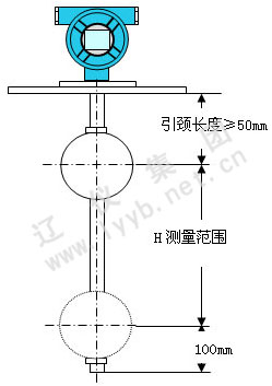

²âÁ¿·¶Î§£º0¡«3500mm
£¨²âÁ¿·¶Î§HͬÒý¾±³¤¶ÈÒÔ¼°×ܳ¤µÄ¹ØÏµÏê¼ûͼ1£©
