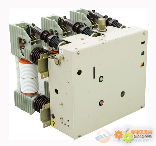

(ZN12-12)ZN12-12,ZN12-12»§ÄÚ¸ßÑ¹Õæ¿Õ¶Ï·Æ÷ÊÇÈýÏཻÁ÷50Hz£»¶î¶¨µçѹΪ12kVµÄ»§ÄÚ×°Öᣱ¾¶Ï·Æ÷µÄ»ú¹¹ÓëÃð»¡ÊÒϵͳÉè¼ÆÎªÒ»Ì壬רÓõÄÎ÷ÃÅ×Ó¹«Ë¾3AFÐ͵¯»É²Ù¶¯»ú¹¹£¬²ÉÓÃÁ½Óõ綯»ú½øÐн»Ö±Á÷´¢ÄܲÙ×÷£¬Ò²¿ÉÓÃÊÖ¶¯²Ù×÷¡£±¾²úÆ·Éè¼ÆÓÐ210mm¡¢230mm¡¢250mm¡¢275mmµÈ¶àÖÖÏà¼ä¾àÀ룬Ó벻ͬÐͺŵĿª¹Ø¹ñÅäºÏʹÓøü¼Ó·½±ã¡£±¾²úÆ·¿ÉÓÃÓÚJYN2-12¡¢JYN6¡ª12¡¢KYN2-12ÊÖ³µÉÏ£¬ÊÖ³µÕûÌå³ß´çÓëZN28¡ª12CÏàͬ£¬¿É·Ö±ð²ÎÕÕZN28-12C²¿·Ö¡£È«¹úÃâ·ÑÏúÊÛÈÈÏß400-6276-518
ZN12-12/1250-20
ZN12-12/1250-25
ZN12-12/1250-31.5
ZN12-40.5/1250-31.5
ZN12-40.5/1250-40
ZN12-40.5/1600-31.5
ZN12-40.5/1600-40
ZN12-40.5/2000-31.5
±¾²úÆ·Éè¼ÆÓУº350mm,400mm,460mm µÈ¶àÖÖÏà¼ä¾àÀ룬Óû§Ó벻ͬÐͺŵĿª¹Ø¹ñÅäºÏʹÓøü¼Ó·½±ã¡£¿ÉÔڹ̶¨¹ñXGN17-40.5ÖÐʹÓã¬Ò²¿ÉÔÚJYN1-40.5 ¡¢KYN12-40.5¹ñÖÐʹÓÃ
1. »ú¹¹¼òµ¥£¬¿ª¶ÏÄÜÁ¦Ç¿£¬ÊÙÃü³¤£¬²Ù×÷¹¦ÄÜÆëÈ«£¬ÎÞ±¬Õ¨Î£ÏÕ£¬
2. ÊÊÓ÷¶Î§¹ã£¬¿ÉÂú×ãÈ«¹¤¿öÌõ¼þµÄÒªÇó£¬
3. ÅÀµç±È¾à´óÓÚ20mm/kV£¬µçÆø¼ä϶´óÓÚ138mm£¬
4. ÊÔÑé²ÎÊýÌá¸ß£¬¿ª¶ÏµçÁ÷31.5kAµÄ¶Ï·Æ÷£¬Æä¶î¶¨¶Ì·¹ØºÏµçÁ÷ºÍ¶î¶¨·åÖµÄÍÊܵçÁ÷´ï100kA£¬¿ª¶ÏµçÁ÷40kAµÄ¶Ï·Æ÷£¬Æä¶î¶¨¶Ì·¹ØºÏµçÁ÷ºÍ¶î¶¨·åÖµÄÍÊܵçÁ÷´ï130kA£¬ÁíÍâÆä·Ç¶Ô³Æ¿ª¶ÏµÄÖ±Á÷·ÖÁ¿Îª45%
5. ͨ¹ýȼ»¡ÊÔÑéºÍÄý¶ÎÛ»àÊÔÑé¡£¡¡ ¡¡
