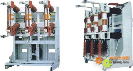

(ZN39-40.5)ZN39-40.5¸Ã¶Ï·Æ÷²ÉÓÃ¿ÕÆø¾øÔµ£¬¶Ï·Æ÷Âú×ãÕý³£ÔËÐÐÌõ¼þÏÂµÄ¿ÕÆø¾àÀëºÍÅÀ¾àÒªÇó£¬×ÜÌå¶øÒѺÏÀí£¬½á¹¹Îȶ¨£¬×°µ÷±ãÀû¡£
²Ù×÷»ú¹¹²ÉÓõç´Å»úеCD10-III»òµ¯»É»úеCT19N¡£
¶Ï·Æ÷ÓÐÒ»Ì×ÁªËø×°Öã¬Ó뿪¹Ø¹ñÅäÌ×ʹÓ㬲ÉÓÃÇ¿ÖÆ»úе±ÕËø·½Ê½£¬Âú×㿪¹Ø¹ñ¡°Îå·À¡±¹¦ÄÜÒªÇó¡£

1 ¶î¶¨µçѹ kV 40.5
2 ¶î¶¨µçÁ÷ A 1000,1250,1600
3 ¶î¶¨ÆµÂÊ Hz 50
4 ¶î¶¨¶Ì·¿ª¶ÏµçÁ÷ kA 25,31.5
5 ¶î¶¨¶Ì·¹ØºÏµçÁ÷ kA 63,80
6 ¶î¶¨·åÖµÄÍÊܵçÁ÷ kA 63,80
7 ¶î¶¨¶ÌʱÄÍÊܵçÁ÷ kA 25,31.5
8 ¶î¶¨¶Ì·³ÖÐøÊ±¼ä s 4
9 ¶î¶¨²Ù×÷˳Ðò ·Ö-0.3s-ºÏ·Ö-180s-ºÏ·Ö
10 ¶î¶¨µ¥¸öµçÈÝÆ÷×鿪¶ÏµçÁ÷ A 400
11 ¶î¶¨µ¥¸ö±³¶Ô±³µçÈÝÆ÷×鿪¶ÏµçÁ÷ A 400
12 ¶î¶¨µçÈÝÆ÷×鹨ºÏÓ¿Á÷(ƵÂʲ»´óÓÚ1.000Hz) kA 8.0
13 ÒìÏà½ÓµØ¹ÊÕÏÌõ¼þϵĶÌ·¿ª¶ÏµçÁ÷ kA 31.75
14 ³öÏ߶˶Ì·¹ÊÕÏÊÔÑ鷽ʽ5Ö±Á÷·ÖÁ¿°Ù·ÖÊý 40£¥
15 ¶î¶¨¾øÔµË®Æ½ 1min¹¤ÆµÄÍÊܵçѹ ¼«¶ÔµØ¡¢¼«¼ä kV 95
¶Ï¿Ú¼ä kV 95
À×µç³å»÷ÄÍÊܵçѹ ¼«¶ÔµØ¡¢¼«¼ä kV 185
¶Ï¿Ú¼ä kV 185
16 ¿ª¶Ïʱ¼ä ms ¡Ü8.0
17 »úеÊÙÃü ´Î 10000
18 ¶î¶¨¶Ì·¿ª¶ÏµçÁ÷¿ª¶Ï´ÎÊý ´Î 30
19 ȼ»¡Ê±¼ä ms ¡Ü15
ZN39-40.5ÐÍϵÁл§ÄÚ¸ßÑ¹Õæ¿Õ¶Ï·Æ÷,ϵÈýÏཻÁ÷50Hz,¶î¶¨µçѹ40.5kVµÄ»§ÄÚ¸ßѹÅäµç×°Öá£ÓëJYN1-35,GBC-35¿ª¹Ø¹ñÅäÌ×ʹÓᣲúÆ··ûºÏGB1984¡¶½»Á÷¸ßѹ¶Ï·Æ÷¡·Ö®ÒªÇó¡£ÅäÌײúÆ·ÓУº¸ôÀëÊÖ³µ¼°PTÊÖ³µµÈ¡£
