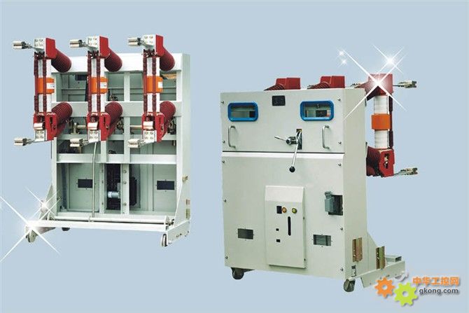

(ZN23-40.5)ZN23-40.5,ZN23-40.5ϵÁл§ÄÚ¸ßÑ¹Õæ¿Õ¶Ï·Æ÷ÊÇÈýÏཻÁ÷50Hz£¬¶î¶¨µçѹΪ40.5kVµÄ»§ÄÚ×°Öã¬ÅäÓÐCT19µ¯»É²Ù¶¯»ú¹¹¡£²úÆ··ÖΪ¹Ì¶¨Ê½ºÍÊÖ³µÊ½Á½ÖÖ¡£¹Ì¶¨Ê½ÊÇÅäÖÃXGN17-40.5Ïäʽ¹Ì¶¨Ê½¸ßѹ¿ª¹Ø¹ñÖÐʹÓã»ÊÖ³µÊ½ÅäÖÃÔÚJYN1-40.5ÊÖ³µÉÏÔÚJYN-40.5ÒÆ¿ªÊ½½ðÊô·â±Õ¿ª¹Ø¹ñ»òGBC¸ßѹ¿ª¹Ø¹ñÖÐʹÓã¬Ò²¿ÉÅäÖÃÔÚKYN10-40.5ÊÖ³µÉÏÔÚKYN10-40.5×éװʽ½ðÊô·â±Õ¿ª¹Ø¹ñÖÐʹÓᣠ±¾ÏµÁвúÆ·¼¼Êõ²ÎÊý¸ß¡¢¿ª¶ÏÄÜÁ¦Ç¿¡¢¶¯×÷¿É¿¿¡¢ÐÔÄÜÎȶ¨¡¢ÊÙÃü³¤¡¢Î¬»¤¼ò±ã£¬¹©¹¤¿óÆóÒµ£¬·¢µç³§¼°±äµçÕ¾¿ØÖÆÖ®Ó㬲¢ÊÊÓÃÓÚÆµ·±²Ù×÷µÄ³¡Ëù£¬Ò²¿ÉÓÃÓÚÇкϵçÈÝÆ÷×éµÈÌØÊⳡºÏ¡£
