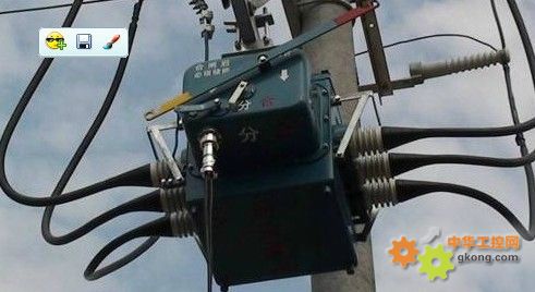

(FZW28-12)FZW28-12(VSP5) ÓÃÓڼܿÕÏß·ÅäµçϵͳÓõIJÙ×÷¿ØÖÆ¿ª¹Ø£¬ÓжàÖÖÐÍʽ£¬VPS5-12ÐÍÖùÉÏÕæ¿Õ¸ººÉ¿ª¹Ø¾ßÓÐÎÞÓÍ¡¢»ú¹¹¼òµ¥¡¢ÐÔÄܿɿ¿ÎÞÐèά»¤µÈÍ»³öÓŵ㣬ÖÁ½ñÒѱ»¹ã·ºÊ¹Ó᣸òúÆ·ÓëFDRÐ͹ÊÕϼì²âÆ÷»òRTUÒ£¿ØÖÕ¶Ë×°ÖõÈÉ豸Ïà½áºÏ£¬¹¹³É½á¹¹Ê®·Ö¼òµ¥µÄÅäµç×Ô¶¯»¯ÏµÍ³£¬Ëü¿ÉÒÔʵÏּܿÕÏß·¹ÊÕϵÄ×Ô¶¯¶¨Î»ºÍ¹ÊÕ϶εÄ×Ô¶¯¸ôÀ롣ΪÁ˸üÐÂÎÒ¹úÏÖÓеÄÅäµç¿ª¹ØÉ豸£¬Ê¹Ö®ÊµÏÖÎÞÓÍ»¯ºÍ×Ô¶¯»¯ÎªÌØÕ÷µÄÅäµçÉ豸¸ÄÔìµÄÐèÒª
ÊÊÓÃÓÚ10kVÅäµçÏß·£¬¿ÉÒÔ±ÜÃâÅäµçÍøÓû§Ö§Ïß¹ÊÕÏ»ò±£»¤ÅäºÏ²»µ±¶ø²¨¼°ÕûÌõÀ¡ÏßÍ£µç£¬¼õÉÙ¹©µç²¿ÃźÍÓû§Ö®¼äÔðÈξÀ·×£¬¹¹½¨»ùÓÚÓû§·Ö½ç¸ººÉ¿ª¹ØºÍÓû§·Ö½ç¿ª¹Ø²â¿Øµ¥Ôª×é³ÉµÄÓû§·Ö½ç¸ººÉ¿ª¹Ø³ÉÌ××°Öã¨Ë׳ƿ´ÃŹ·£©¡£¸ÃϵͳÊÊÓÃÓÚ¸÷Öֽӵط½Ê½µÄ¼Ü¿ÕÍø¡¢µçÀÂÍø¡¢¼Ü¿ÕµçÀ»ìºÏÍø·ÖÖ§Ïß×Ô¶¯»¯¼à¿Ø¡£
    1¡¢¿É¼ì²âºÁ°²¼¶µÄÏß·ÁãÐòµçÁ÷¼°25±¶¶î¶¨ÖµµÄÏà¼ä¶Ì·µçÁ÷£¬²â¿Ø×¼È·¡¢¶¯×÷ÁéÃô;
    2¡¢Í¬Ò»¹æ¸ñ²úÆ·¿ÉÊÊÓÃÓÚ²»Í¬ÖÐÐÔµã½ÓµØÔËÐз½Ê½µÄµçÁ¦Åäµçϵͳ£»
    3¡¢Õæ¿ÕÃ𻡣¬SF6Íâ¾øÔµ£¬ÄÚÖøôÀëµ¶ÓëÃð»¡ÊÒÒì²½Áª¶¯£¬¿ª¹Ø·ÖºÏÄÜÁ¦Ç¿£¬°²È«ÐԺã»
    4¡¢Latchʽµ¯»É²Ù×÷»ú¹¹£¬À­¸ËʽÊÖ¶¯ºÏÕ¢£¬ÊÖ¶¯»òµç¶¯Íѿ۷ÖÕ¢£¬²Ù×÷¼ò½à·½±ã£»
    5¡¢¹¤×÷µçÔ´£¨µçѹ»¥¸ÐÆ÷£©ÄÚÖ㬳ÉÌ×É豸ÕûÌåÃâά»¤ÐԸߣ»
    6¡¢ËùÓв¿¼þÈ«Ãܷ⣬ÄͺòÐÔÇ¿£¬¿¹Äý¶ÐÔÄܺã»
    7¡¢È«º½¿Õ²åÍ·µçÆøÁ¬½Ó£¬°²×°Í¶ÔË¿ì½Ý¡¢·½±ã¡¢ÕýÈ·¡¢¿É¿¿£»
    8¡¢¾ßÓÐÏß·¹ÊÕϼǼSOE£¬¿É·´Ó³¹ÊÕÏ·¢Éúʱ¼ä¡¢¹ÊÕÏÐÔÖÊ£¨½ÓµØ»ò¶Ì·¹ÊÕÏ£©¡¢¹ÊÕÏʱ¿ÌµÄµçÁ÷Öµ¼°Õû¶¨Öµ£¬Ö÷¶¯ÉÏË͹ÊÕÏÐÅÏ¢£»
    9¡¢Ò»°ãÑ¡ÔñÎÞͨÐÅ·½Ê½ÔËÐУ¬Ò²¿É¸ù¾ÝÐèÒªÅäÖÃÓÐÏß»òÎÞÏßͨÐÅÄ£¿é£¬Ñ¡ÔñPC»ú²â¿ØÏµÍ³»òPDA½øÐм¯ÖÐÊý¾Ý¹ÜÀí¡£
