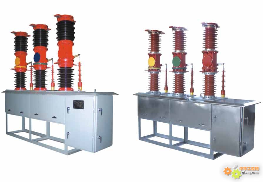

ZW7-40.5Åú·¢£¬ZW7-40.5Åú·¢¼ÛÏúÊÛ£¬ZW7£­40.5ϵÁл§Íâ¸ßÑ¹Õæ¿Õ¶Ï·Æ÷£¬Ö÷ÒªÓÃÓÚ»§Íâ35KVÊä±äµçϵͳµÄ¿ØÖÆÓë±£»¤£¬Ò²¿ÉÊÊÓÃÓڳǡ¢ÏçµçÍø¼°¹¤¿óÆóÒµµÄÕý³£²Ù×÷Óë¶Ì·±£»¤Ö®Ó᣸òúÆ·×ÜÌå½á¹¹Îª´Éƿ֧Öùʽ£»ÉÏ´ÉÆ¿ÄÚ×°Õæ¿ÕÃð»¡ÊÒ£¬ÏÂ´ÉÆ¿ÎªÖ§Öù´ÉÆ¿¡£ÊÊÓÃÓÚÆµ·±²Ù×÷µÄ³¡Ëù¡£²¢¾ßÓÐÃÜ·âÐԺᢿ¹ÀÏ»¯¡¢Ä͸ßѹ¡¢²»È¼ÉÕ¡¢ÎÞ±¬Õ¨¡¢Ê¹ÓÃÊÙÃü³¤¡¢°²×°Î¬»¤·½±ãµÈÓŵ㡣
Ö÷Òª¼¼Êõ²ÎÊý
ÐòºÅ Ãû³Æ µ¥Î» ÊýÖµ
1 ¶î¶¨µçѹ kV 40.5
2 ¶î¶¨µçÁ÷ A 1600
3 ¶î¶¨ÆµÂÊ Hz 50
4 ¶î¶¨¶Ì·¿ª¶ÏµçÁ÷£¨ÓÐЧֵ£© kA 20 25 31.5
5 ¶î¶¨¶Ì·¹ØºÏµçÁ÷£¨·åÖµ£© 50 63 80
6 ¶î¶¨·åÖµÄÍÊܵçÁ÷ 50 63 80
7 4s¶î¶¨¶ÌʱÄÍÊܵçÁ÷£¨ÓÐЧֵ£©
 20 25 31.5
8 1min¹¤ÆµÄÍÊܵçѹ£¨ÓÐЧֵ£© kV ¸Éʽ£º95£¨ÊªÊ½£º80£©
9 À×µç³å»÷ÄÍÊܵçѹ£¨·åÖµ£© 185
10 ¶î¶¨²Ù×÷˳Ðò   ·Ö¡ª0.3sºÏ·Ö¡ª180s¡ªºÏ·Ö
11 ¶î¶¨¶Ì·¿ª¶ÏµçÁ÷¿ª¶Ï´ÎÊý ´Î 20
12 »úеÊÙÃü 10000
13 ÖØÁ¿ kg 1000
 Ö÷Òª»úÐµÌØÐÔ²ÎÊý
ÐòºÅ Ãû³Æ µ¥Î» ÊýÖµ
1 Ãð»¡ÊÒ´¥Í·¿ª¾à mm 22¡À2
2 Ãð»¡ÊÒ´¥Í·³¬ÐÎ³Ì 5¡À1
3 Ïà¼äÖÐÐľà 710
4 Ãð»¡ÊÒ´¥Í·ºÏÕ¢µ¯ÌøÊ±¼ä ms ¡Ü5
5 ÈýÏà·Ö¡¢ºÏÕ¢²»Í¬ÆÚÐÔ ¡Ü2
6 ƽ¾ùºÏÕ¢ËÙ¶È m/s 0.75¡À0.2
7 ƽ¾ù·ÖÕ¢ËÙ¶È 1.7¡À0.2
8 ºÏբʱ¼ä ms 30~100
9 ·Öբʱ¼ä 15~60
10 ÿÏàÖ÷»ØÂ·µç×裨²»°üÀ¨µçÁ÷»¥¸ÐÆ÷£© ¦Ì¦¸ ¡Ü100
11 Õæ¿ÕÃð»¡ÊÒ¶¯¾²´¥Í·ÔÊÐíÄ¥Ëðºñ¶È mm 3
ZW7-40.5/630-25
ZW7-40.5/1250-31.5
ZW7-40.5/1600-31.5
ZW7-40.5/2000-31.5
