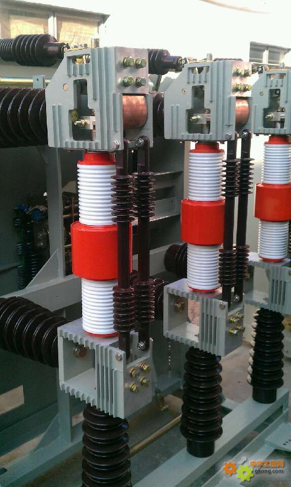

ZN39-40.5»§ÄÚ¸ßѹ¿ª¹Ø£¬ZN39-40.5ÐÍϵÁл§ÄÚ¸ßÑ¹Õæ¿Õ¶Ï·Æ÷£¬ÏµÈýÏཻÁ÷50Hz¡¢¶î¶¨µçѹ40.5kVµÄ»§ÄÚ¸ßѹÅäµç×°Öá£ÓëJYN1-35£¬GBC-35¿ª¹Ø¹ñÅäÌ×ʹÓᣲúÆ··ûºÏGB1984¡¶½»Á÷¸ßѹ¶Ï·Æ÷¡·Ö®ÒªÇó¡£ÅäÌײúÆ·ÓУº¸ôÀëÊÖ³µ¼°PTÊÖ³µµÈ¡£

ZN39-40.5ÐÍϵÁл§ÄÚ¸ßÑ¹Õæ¿Õ¶Ï·Æ÷£¬ÏµÈýÏཻÁ÷50Hz¡¢¶î¶¨µçѹ40.5kVµÄ»§ÄÚ¸ßѹÅäµç×°Öá£ÓëJYN1-35£¬GBC-35¿ª¹Ø¹ñÅäÌ×ʹÓ᣸öϷÆ÷²ÉÓÃ¿ÕÆø¾øÔµ£¬¶Ï·Æ÷Âú×ãÕý³£ÔËÐÐÌõ¼þÏÂµÄ¿ÕÆø¾àÀëºÍÅÀ¾àÒªÇó£¬×ÜÌå¶øÒѺÏÀí£¬½á¹¹Îȶ¨£¬×°µ÷±ãÀû¡£
