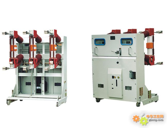

²úÆ·Ãû³Æ£º ZN23-40.5ÊÖ³µÊ½¸ßѹ¿ª¹Ø
ÐÍ ºÅ£º ZN23-40.5
Æ· ÅÆ£º 11328
ZN23-40.5ÊÖ³µÊ½¸ßѹ¿ª¹Ø,ZN23-40.5ϵÁл§ÄÚ¸ßÑ¹Õæ¿Õ¶Ï·Æ÷ÊÇÈýÏཻÁ÷50Hz£¬¶î¶¨µçѹΪ40.5kVµÄ»§ÄÚ×°Öã¬ÅäÓÐCT19µ¯»É²Ù¶¯»ú¹¹¡£²úÆ··ÖΪ¹Ì¶¨Ê½ºÍÊÖ³µÊ½Á½ÖÖ¡£¹Ì¶¨Ê½ÊÇÅäÖÃXGN17-40.5Ïäʽ¹Ì¶¨Ê½¸ßѹ¿ª¹Ø¹ñÖÐʹÓã»ÊÖ³µÊ½ÅäÖÃÔÚJYN1-40.5ÊÖ³µÉÏÔÚJYN-40.5ÒÆ¿ªÊ½½ðÊô·â±Õ¿ª¹Ø¹ñ»òGBC¸ßѹ¿ª¹Ø¹ñÖÐʹÓã¬Ò²¿ÉÅäÖÃÔÚ KYN10-40.5ÊÖ³µÉÏÔÚKYN10-40.5×éװʽ½ðÊô·â±Õ¿ª¹Ø¹ñÖÐʹÓᣠ
±¾ÏµÁвúÆ·¼¼Êõ²ÎÊý¸ß¡¢¿ª¶ÏÄÜÁ¦Ç¿¡¢¶¯×÷¿É¿¿¡¢ÐÔÄÜÎȶ¨¡¢ÊÙÃü³¤¡¢Î¬»¤¼ò±ã£¬ÇÒÎÞ**ΣÏÕ¼°ÎÛȾ£¬¹©¹¤¿óÆóÒµ£¬·¢µç³§¼°±äµçÕ¾¿ØÖÆÖ®Ó㬲¢ÊÊÓÃÓÚÆµ·±²Ù×÷µÄ³¡Ëù£¬Ò²¿ÉÓÃÓÚÇкϵçÈÝÆ÷×éµÈÌØÊⳡºÏ¡£
ʹÓû·¾³
1¡¢ÖÜΧ¿ÕÆøÎ¶ȣºÉÏÏÞ+40¡æ£¬ÏÂÏÞ-10¡æ£¬¸ßº®µØÇø-25¡æ;
2¡¢º£°Î£º1000m;
3¡¢Ïà¶Ôʪ¶È£ºÈÕÆ½¾ùÖµ²»´óÓÚ95%£»ÔÂÆ½¾ù²»´óÓÚ90%£»£¨+25¡æ£©£»±¥ºÍÕôÆûѹ£ºÈÕÆ½¾ù²»´óÓÚ2.2¡Á10-3MPa£¬ÔÂÆ½¾ù²»´óÓÚ1.8¡Á10-3MPa
4¡¢Õñ¸££ºµØÕðÁҶȲ»³¬¹ý8¶È£»
Ðͺź¬Òå
    ZN23-40.5C/2000-31.5
    ZN--»§ÄÚÕæ¿Õ¶Ï·Æ÷
    23---Éè¼ÆÐòºÅ
    40.5 ---¶î¶¨µçѹ£¨KV£©
    C----ÊÖ³µÊ½
    2000---¶î¶¨µçÁ÷£¨A£©
    31.5---¶î¶¨¶Ì·¿ª¶ÏµçÁ÷£¨KA£©
ZN23-40.5/T2000-31.5ÐÍ»§ÄÚ½»Á÷¸ßÑ¹Õæ¿Õ¶Ï·Æ÷£¬ÅäÓÃCT1BNÐ͵¯»É²Ù¶°»ú¹¹£¬ÊÊÓÃÓÚÈýÏཻÁ÷50HZ¡¢40.5KVµçÁ¦ÏµÍ³ÖУ¬¿É¹©¿óÆóÒµ£¬·¢µç³§¼°±äµçÕ¾×÷Ϊ·ÖºÏ¸ººÉµçÁ÷£¬¹ýÔØµçÁ÷¹ÊµçÁ÷Ö®Ó㬲¢ÊÊÓÃÓÚÆµ·±²Ù×÷µÄ³¡ºÏ¡£²»ÊÊÓÃÓÚÒ×ȼÒ×±¬µÈΣÏÕ³¡Ëù
